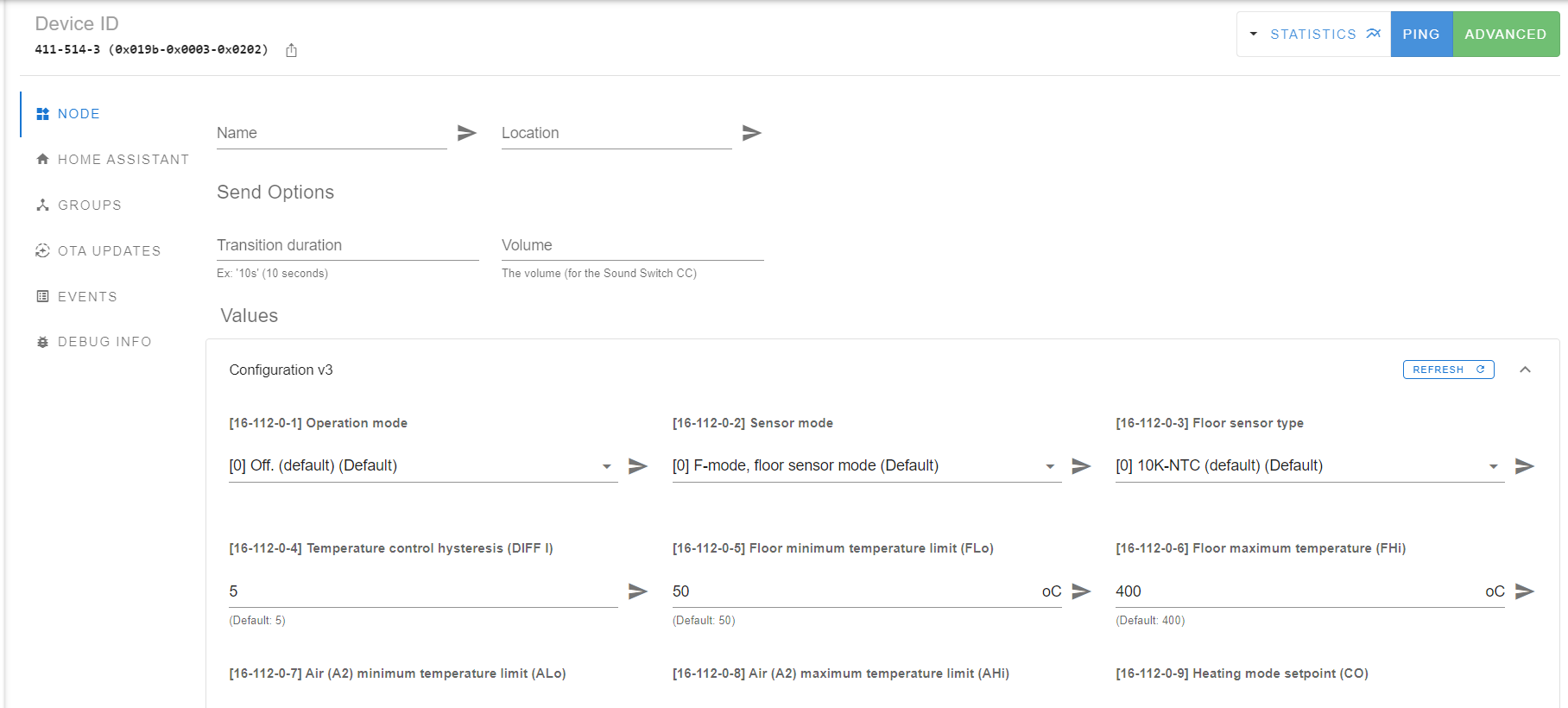

Is there a way to control Zwave devices / configuration values through an API? I'm aiming to update these values:
Schermafbeelding 2023-01-07 090145.png (71.17 KiB) Viewed 1971 times

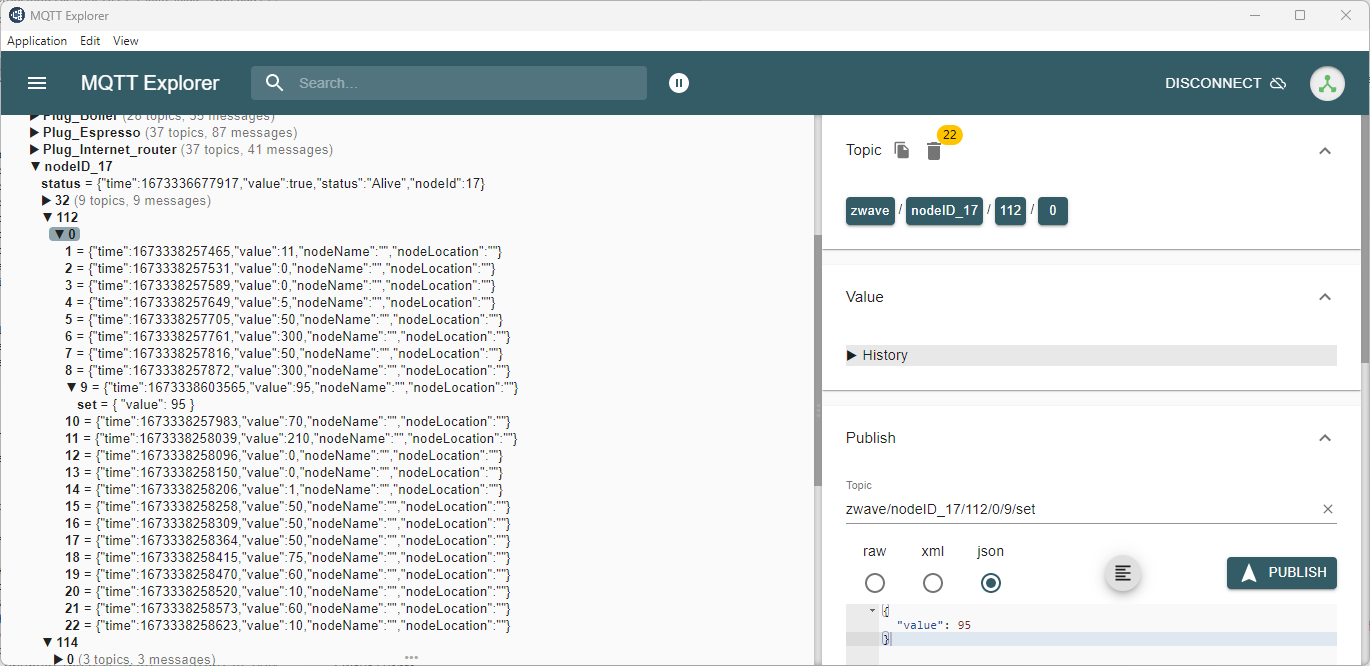

I've done some tests and I'm now able to update the parameters according to the MQTT API manual, through MQTT Explorer. See the example where I've successfully updated the thermostat value tot 95 (9.5 degrees):
Schermafbeelding 2023-01-10 091706.png (120.76 KiB) Viewed 1929 times
