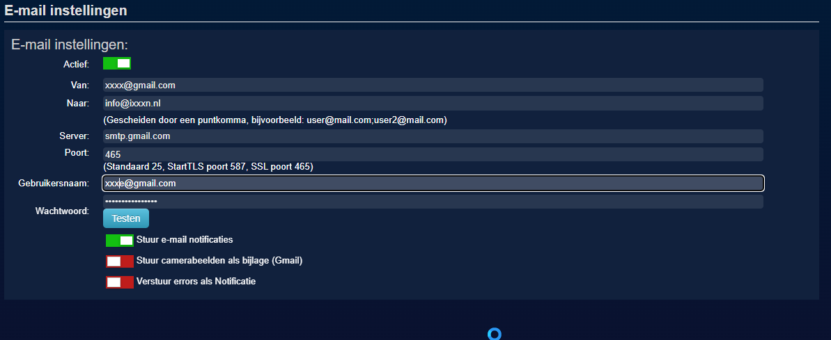

I did the thnigs you say..:
Only still
Log and settings ..
Did not working?

And
I Copy paste the password

No, I can't get it to work, even though I've done everything here. Have I written correctly?
should I write ?
Server:
smtp.gmail.com
Port:465
User name:[email protected]
Password:

losholmen wrote: Tuesday 10 January 2023 12:01 No, I can't get it to work, even though I've done everything here. Have I written correctly?
libcurl returns 3 (CURLE_URL_MALFORMAT). So double check smtp server + port (that will be used to build the url), that indeed looks correct, does not include a non printable char that cannot be seen in your capture but that is taken into account by libcurl.
Otherwise, try hereupper proposed checks to be able to see is server can be reached and what is advertised as supported login methods. Those printed are the one I get and no issue with domoticz configured like you, provided you use the configured application password (Oauth is not implemented in Domoticz).
