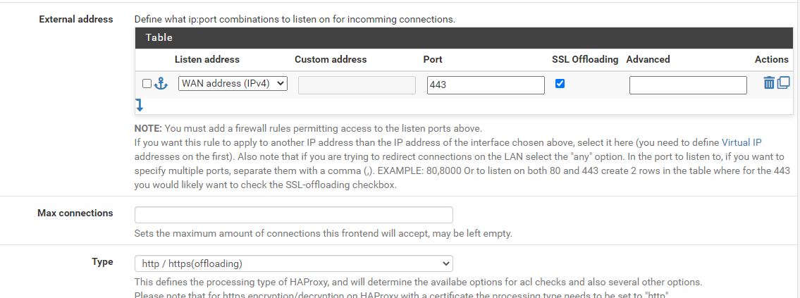

HAproxy Frontend Setup:
Frontend Setup.JPG (79.35 KiB) Viewed 2760 times

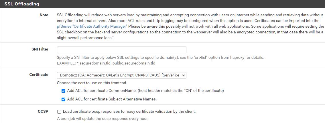

SSL Offloading.JPG (86.32 KiB) Viewed 2760 times

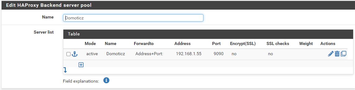

HAproxy Backend Setup:
The backend of HAproxy to Domoticz is setup to the HTTP server on port 9090
And I copied PEM file which ACME has created, to the domoticz folder and renamed it to server_cert.pem

are these errors because of the HAproxy or Domoticz configuration?

I see 2 possible issues
1) You run the SSL version on privileged port 443 (any port below 1024 is a privileged port) so you need to run domoticz with admin (root) right to be able to use that port. It is better/safer to run Domoticz as a normal user and use a different port (9443 for example) when starting Domoticz.
2) You run behind a Proxy (which is a good choice) but looking at the Request Headers that Domoticz receives, it does not get any indication that it is called via a Proxy. Looking at the Web ACLF log line, Domoticz only 'sees' a request incoming from 192.168.1.1 which is your Proxy. This is an address that is within the Trusted Network, so no login required.
You need to configure HA Proxy to forward the origin IP address of the request to Domoticz using a Proxy Header. See this link for information on how to do that for HA Proxy (Enterprise).
Once configured correctly, the debug log of Domoticz should show that it receives some additional Request Headers that will show the origin of the request which Domoticz will than use to validate if a login screen should- or should not be presented to allow access.
