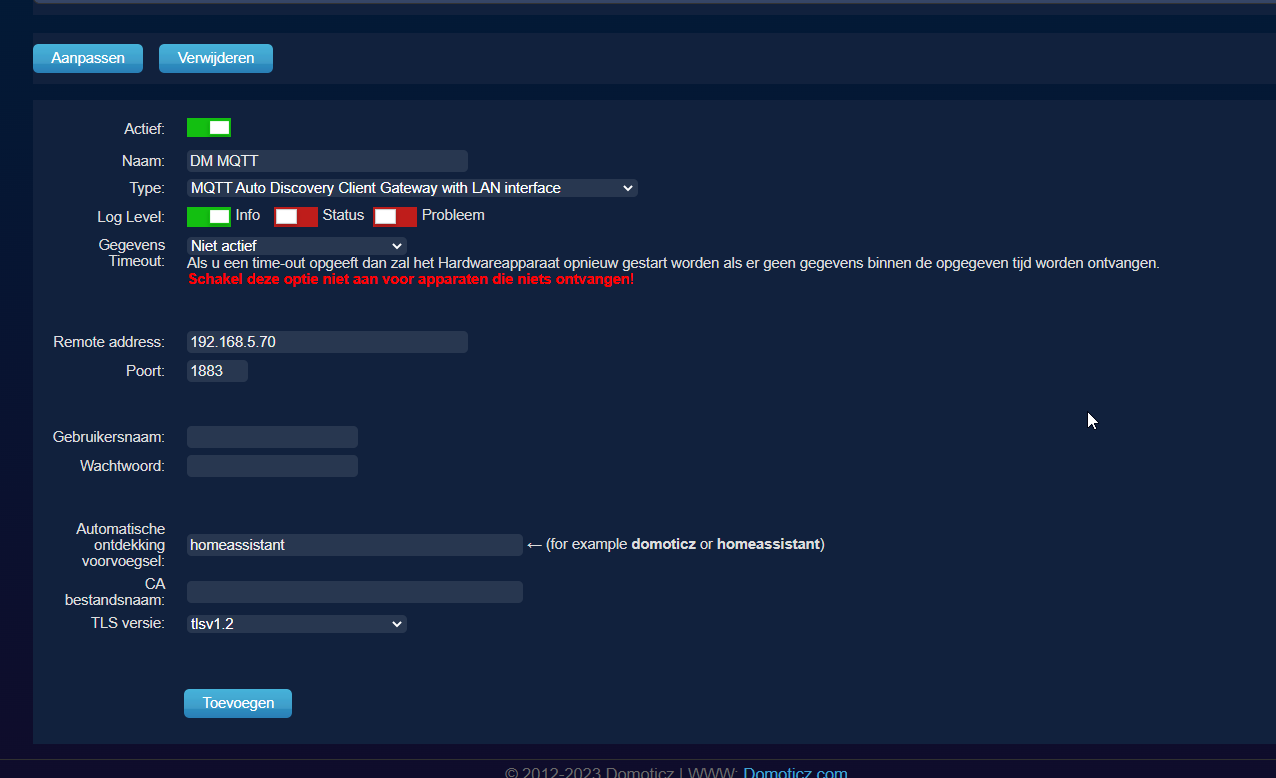

Try teh hardcore version in Domoticz. Working great, and all the devices/settings are in your backup etc. [ no other save options needed.. ]

You can set in Domoticz a new hardware, mqttmanjh wrote: Monday 02 January 2023 20:02Where exactly can I find this "hardcore version"? I have used the python plugin in 2 versions (latest stable and the beta), and also the AutoDiscovery version.Derik wrote: Sunday 01 January 2023 13:43This is the problem with 1 developer....manjh wrote: Saturday 31 December 2022 16:44 I see that the author of this plugin has not been active on this forum since September... given the fact that he is located in the Ukrain, I worry about his well being.
Does anyone have information? Is he OK?

I already have MQTT as hardware device, I use this to communicate with a remote server in my holiday home.Derik wrote: Monday 02 January 2023 20:05You can set in Domoticz a new hardware, mqttmanjh wrote: Monday 02 January 2023 20:02Where exactly can I find this "hardcore version"? I have used the python plugin in 2 versions (latest stable and the beta), and also the AutoDiscovery version.Derik wrote: Sunday 01 January 2023 13:43
Is this "hardcore version" a different one?
When you put in there homeassistent
all the z2m device are directly in Domoticz without a plugin..
I use domoticz/in and domoticz/out as in- and out-prefixes.
Where do you suggest I put "homeassistent"? Will my other links still work?
Hans

I think the ”hardcore” (or hardcoded maybe, native would be even better I guess) version here refers to the ”autodiscovery” which you mentioned you are already running in parallel with this python plugin? So no, there is no third option (well, there is this: https://github.com/zigbeefordomoticz/Domoticz-Zigbee - but I don’t think this is meant here) available a such…
More info about the alternatives: https://www.domoticz.com/wiki/Zigbee#Zi ... n_Domoticz

No i mena.
When you have running z2m or i mean als zigbee2mqtt you can import z2m directly in domoticz without plugin: No other needed....

Yes - but this is the ”autodiscovery” option as can be seen on the hardware name. It is the built-in (native) way to integrate zigbee devices through zigbee2mqtt to Domoticz.
manjh mentions here he has used it already.
