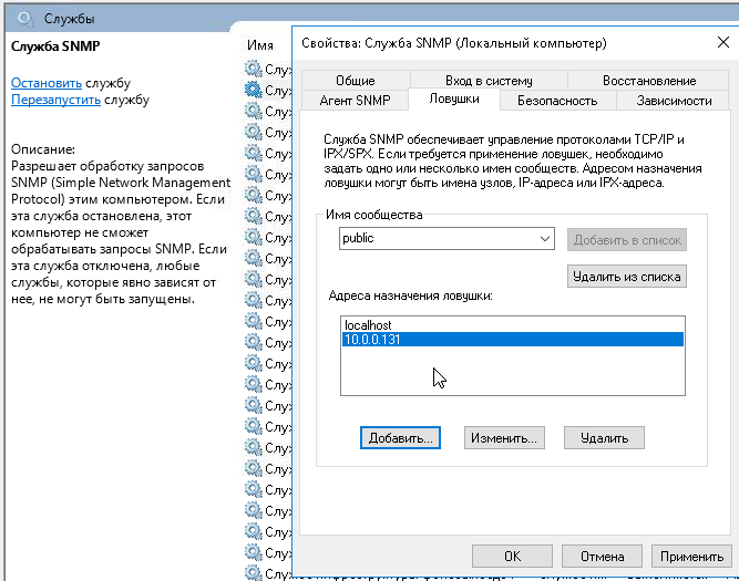

On the “Security” tab, add the community name “Public” with “read only” rights and select the “Receive SNMP packets from any node” option (it is possible to specify only specific addresses of clients).
On the “SNMP Agent” tab, fill in the data as you wish:
You also need to add a “trap” as in the picture, the ip address is Domoticz

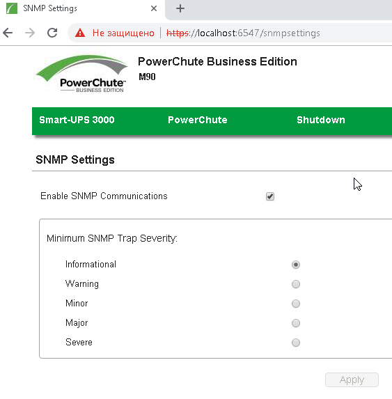

After installation, you must go to the Web interface at: https://localhost:6547 . Most likely, the browser will block the transition and write that we’ll ignore the “connection is not protected” and proceed.
On the “PowerChute” tab, select “SNMP Settings” and activate “SNMPv1”
Reboot.

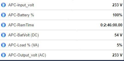

Now creating in Domoticz 1 virtual switch and several sensors (3 for voltage, 2 for %, 1 text and 1 temperature)
The script itself is created here:
UPS_APC.sh in the /domoticz/scripts/ folder
script

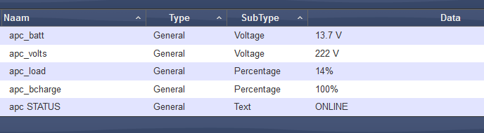

I also have an APC UPS for my domoticz server, and I manage to read the data from the UPS in domoticz.
Only I have two problems; 1; if I run the script with
, then I get as output:
this is the content of readapc.sh
2; I have tried to create the crontab, only I do not know where to make it, and what the exact content should be, I found a crontab in " /etc/crontab " and modified it, only then will the data be not updated in domoticz, in apcupsd i get the actual reading.
Can someone help me with this?

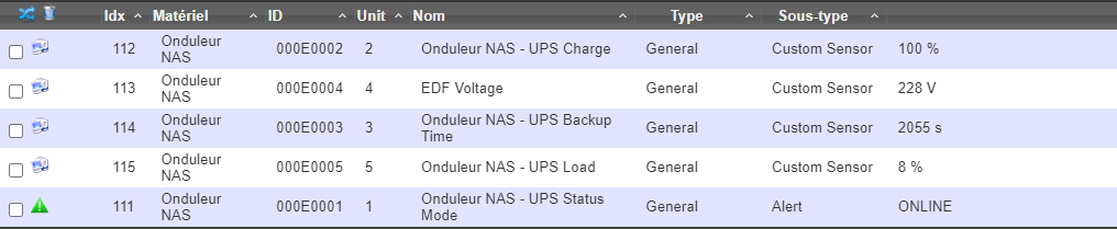

Darkneo
- Posts: 24
- Joined: Sunday 10 February 2019 16:22
Re: APC UPS Monitoring
Hi there,
Just adding my2cents there. I am using the dedicated plugin to monitor my UPS connected to my Domoticz through USB since years now, and have no issues (viewtopic.php?t=18154)
Nothing special, everything is well explained and documented and working properly.
On my side, I added an CM180+ sensor, that gives me my real time consumption for my house .
Just a tricky thing: the CM180 only gives the current, thus I made a custom event to translate it to real power consumption:
local idx = 96 --idx of device virtual to show power consumption
local cm180 = 'Wattmeter' --name of the CM180+ sensor preventing issue if IDX changes
local tension = otherdevices['EDF Voltage'] --Voltage taken from the UPS devices using its name to prevent issues if IDX changes
function round(num, dec)
if num == 0 then
return 0
local mult = 10^(dec or 2)
return math.floor(num * mult + 0.5) / mult
if (devicechanged[cm180]) then
--Computing current
--print('Valeur '..otherdevices[cm180])
p1, p2 = string.match(otherdevices_svalues[cm180], "(%d+.%d*);(%d+.%d*)")
--on les transforme en Ampere
intensite = p1 / tension
--0.01 precision only
intensite = round(intensite, 2)
commandArray[#commandArray+1]={['UpdateDevice'] = idx..'|0|'..intensite} ---- updating power dummy sensor
return commandArray- Attachments
