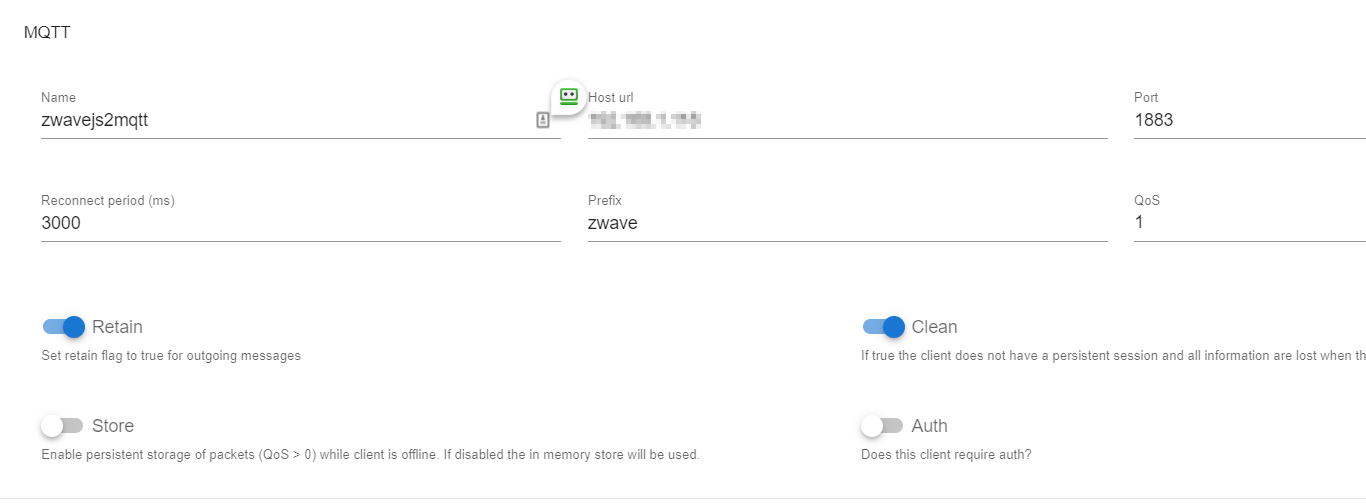

Re: Easiest way to migrate Openzwave to ZWave-JS-UI
Post by mgugu »
2022-12-23 09_45_49-Z-Wave JS UI.png (37.82 KiB) Viewed 11556 times
2022-12-23 09_44_16-Z-Wave JS UI.png (28.8 KiB) Viewed 11556 times

Post by Egregius »
What's the reason to have a different prefix in MQTT and Homeassistant?
mgugu
Posts: 226
Joined: Friday 04 November 2016 12:33
Location: France
Post by mgugu »
Prefix in HA is used for config messages and MQTT prefix used for update messages. This allows to have 2 different topics, improving readability in MQTT explorer and also to avoid possible MQTT loop.
mgugu
Posts: 226
Location: France
Post by mgugu »
And after a successfull integration, NEVER CHANGE the prefixes !
