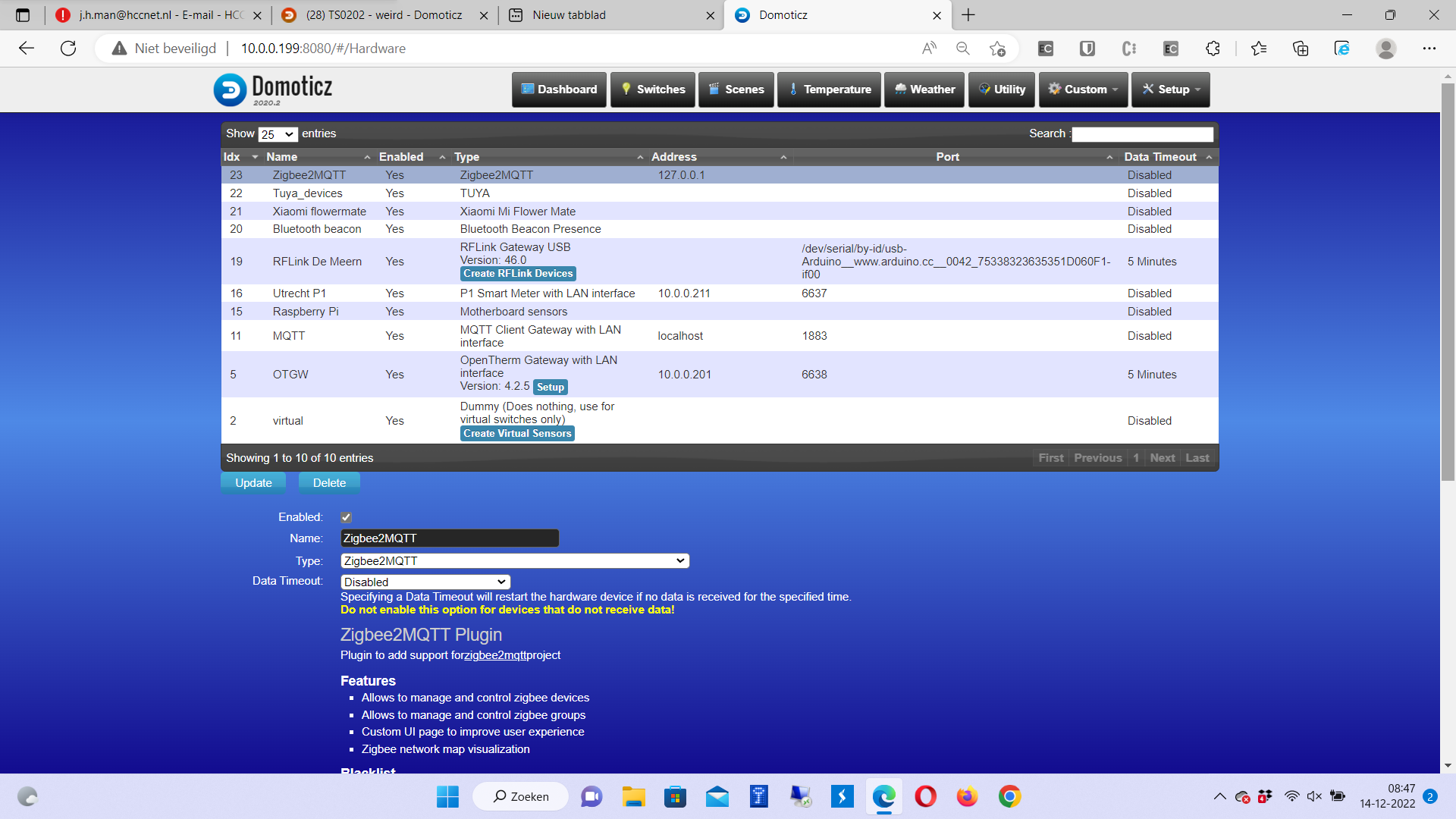

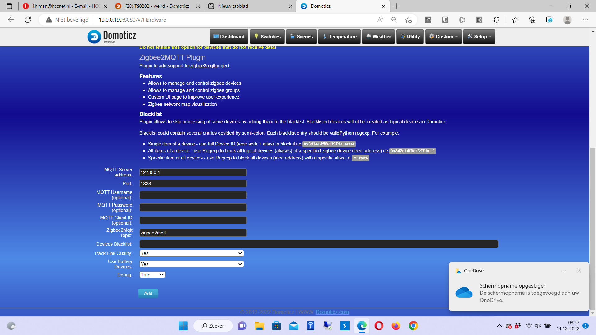

Or can you post a screenshot of the ZIGBEE2MQTT hardware configuration in Domoticz?
manjh
Posts: 749
Joined: Saturday 27 February 2016 12:49
Re: TS0202 - weird
Post by manjh »
waltervl wrote: Tuesday 13 December 2022 21:46 :P The Zigbee2mqtt plugin should do that idx conversion. So that is why it is important to know how you connected zigbee2mqtt with Domoticz. What instructions did you follow? Do you have a link?
2022-12-14 (1).png (230.82 KiB) Viewed 1625 times

So the info is definitely reaching the plugin, but the device in Domoticz is not updated.
After I changed the log level back to "true", the plugin restarts intself and I noticed these lines in the log:
2022-12-17 10:13:45.358 Zigbee2MQTT: Trying to get legacy device 0xa4c138bee718fbf5(keep_)
2022-12-17 10:13:45.358 Zigbee2MQTT: No such device found
2022-12-17 10:13:45.359 Zigbee2MQTT: Creating domoticz device to handle "keep_time" key for device with ieeeAddr 0xa4c138bee718fbf5
Hans
