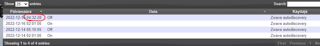

have a bit strange issue. Domoticz seems to get a wrong status from zwajejs2mqtt, but it does not look like it is coming from the bridge. I installed HA to track how it receives the status via mqtt and this reflects the "reality" (turned on at 02:01, turned off at 07:00):
node status in ha.JPG (31.75 KiB) Viewed 1711 times
(I know this is correct as this switch is controlling a water heater which temperature I am tracking as well, and I can see it heated until 7AM)
But for some reason Domoticz sees it like this (turned on at 02:01, turned off at 04:32):
node status in dz.JPG (35.78 KiB) Viewed 1711 times
...to me it looks like that this is coming from mqtt (zwave autodiscovery is the hardware component for zwavejs2mqtt)
What could cause this and is there any meaningful way to try to troubleshoot it?
Posts: 6681
Domoticz version: 2025.1
Re: zwavejs2mqtt
Check the MQTT message with mqtt-explorer, see https://www.domoticz.com/wiki/MQTT#Debugging_MQTT
Check also the domoticz log (menu setup - log). You perhaps have to set it to a file log: https://www.domoticz.com/wiki/Troublesh ... bugging.29

waltervl wrote: Friday 16 December 2022 11:11 Check the MQTT message with mqtt-explorer, see https://www.domoticz.com/wiki/MQTT#Debugging_MQTT
Thanks for the suggestions. I haven't found any meaningful info yet. The recorder is a nice option which I did not know before this. It just seems I cannot set it up to filter just relevant messages. Seems I am getting quite a lot of traffic through mqtt :D I wonder if it is expected that zigbee2mqtt is publishing groups, config etc. every second. Also my Tasmota devices advertise every second. Zwavejs2mqtt does not seem to behave like this.
Anyhow, as the automatic heating takes place during night, I will hold of for now to keep the recorder on for several hour. I took a short recording when I was flipping the switch manually, but as expected the switch operated normally in this test so probably this does not tell anything intersting:
