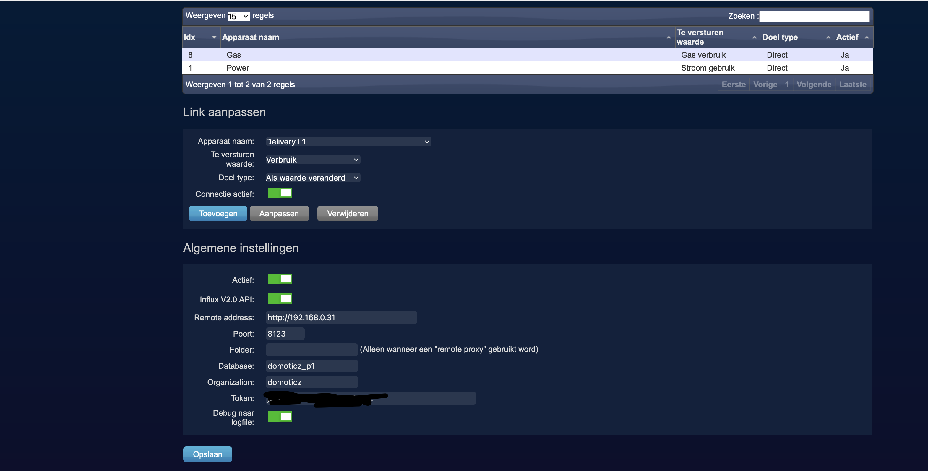

Hi, I want my P1 smart meter data to be send to InfluxDb which is running in a HomeAssitant server as an add-on. I Followed the Wiki page how to set it up. But what ever I try I do not get any data showing up in HA. So nothing is uploaded I guess. These are the settings I have in Domoticz. Now I am not unsure if I have the right (Organisation and Token) but looking into FluxDb I can not find them anywhere.
I remember when creating the influxDB "user" I Had to create user and password for it. Is that what I need Or did I miss a step on that page? Where can I see/ create the token and organisation? Thanks.

You will have to check wether your InfluxDB is version 1 or 2 as that differs.
Check also topic viewtopic.php?t=38992 for v2 authentication

Seems to work now. It is version 1.8. Having the same passwords at both sides made a difference :)
