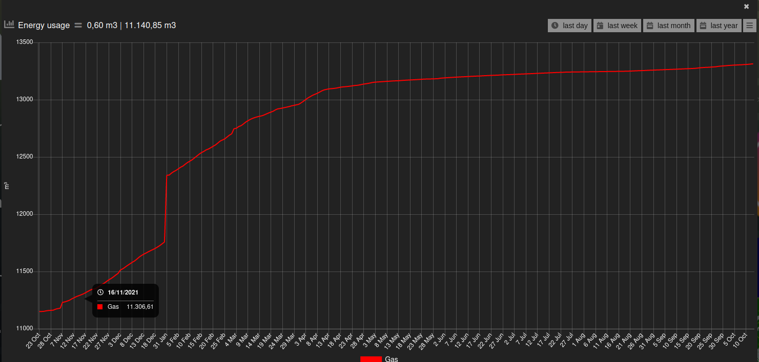

I am trying to make a graph with my yearly gas usage, measured with a P1 device.
The last snag is that I want to subtract the c value of last year.
I checked and I can subtract a constant value from the graph.
data: {
G: 'd.c_3-11140.85',
The value is available. It is in the title even: 11.140.85
But how can I access this in the graph definition?
The value is stored in the counter field of the device. Is it possible to use that in the calculation?

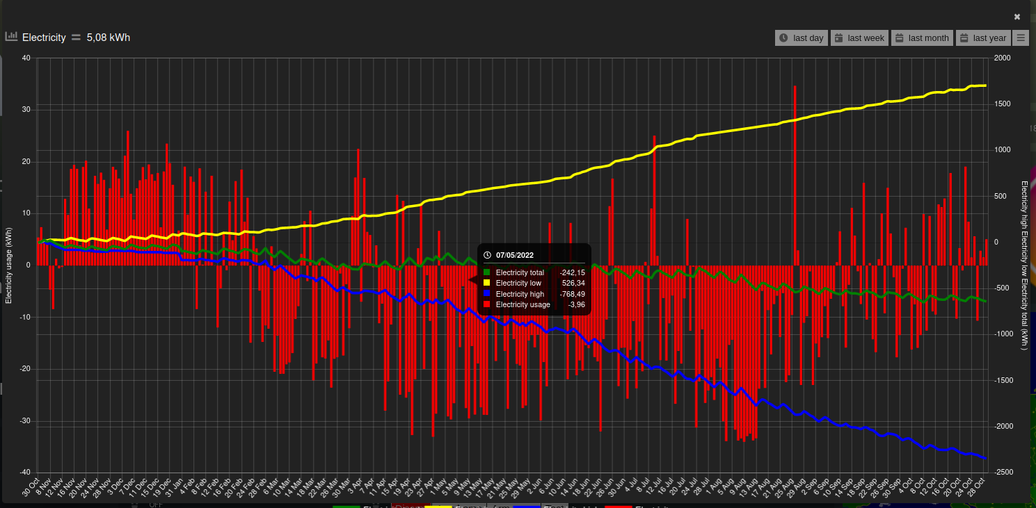

Wow! I love undocumented features!! Thank you very much for your pointer. This was exactly what I was looking for.
With this tip, I was able to finish the graphs I was working on!
I can now plot my daily usage and the cumulative usage over 1 year.
In domoticz I created a dZvents script to collect last years usage in a couple of user variables. (One for low/night tariff and one for high/day tariff)
With your tip I subtract those values from the counter data of my p1 meter to get to the yearly view.
