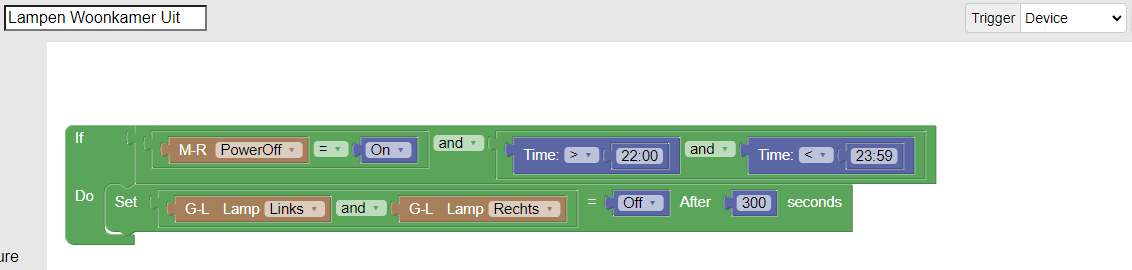

Hopefully you can help me with something, I have made the following Blockly program:
Lampen Woonkamer Uit.png (17.25 KiB) Viewed 3358 times
But what happend is, that within the minut the PowerOff function is on that the lights "Lampen" will go off but jump back on.
It seems that Domoticz checked every minut the cycle or something.
The lights is sent with KAKU 433 in combination of RFXCOM.
The PowerOff is a scene in Logitech Harmony Hub when I shutdown the TV I want 5 minutes later that the light will go off and stay off.

You cannot set 2 lamps with 1 command, it must be..
set Lamp Links = Off after 300 seconds
set Lamp Rechts = Off after 300 seconds
2 separate commands.

Is it also possible to set the time between 22:00 and 07:00 ? or later then 23:59.
I have the feeling that Domoticz reset at 00:00 so if i stay up till 00:20 and i go to bed, the lights won't go off or is this incorrect ?
My scripting skills is horrible, but can you tell me if i do this in lua script how to write it ?
The thing i want is as follow:
When the device PowerOff is 'On' and it is between 22:00 and 03:00 in the night, turn Lamp Links and Right 'Off' after 300 seconds.

if time > 22:00 or time < 07:00...
nitro
Posts: 11
Joined: Sunday 27 October 2019 13:42
Re: Blocky programming not working as expect
Post by nitro »
Thx, that is working indeed :)
