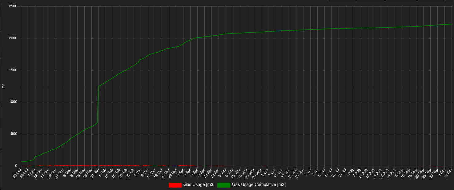

I am trying to plot my daily gas usage as well as my cumulative year usage in one plot.
However my gas usage varies from 0 to 10 m3 per day
while my cumulative goes up to about 2500 m3 over the year.
I would like to define two axis, but both in m3.
But whatever I try in CONFIG.js, it keeps showing only one axis.
How can I plot these two variables in one plot properly?
Screenshot 2022-10-10 at 19-28-09 Dashticz.png (79.64 KiB) Viewed 332 times

You can enforce 2 different y-axes by setting the ylabels parameter, for instance as follows:
      ylabels: ['m3','m3 '],
      legend: { 'U':'Gas Usage','C':'Gas Usage Cumulative'},
There is a space behind the second m3. This makes it different from the first one. Dashticz will create two y-axes.
Additional remarks:
'week' cannot be used as range parameter. It's not supported by Domoticz. You should use 'month'.
For the day graph: Domoticz doesn't provide the cumulative data.
