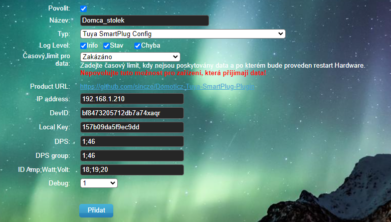

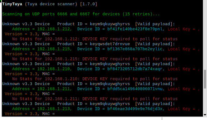

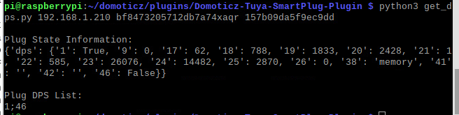

Edit:
I managed to get get_dps.py working. I'm probably getting the information right:
If I use Tinytuya scan, it says that the device version is v3.3.
In tuya smart plugs settings I have this:
Until then, everything would probably be fine. But of course I don't see any data (watt, volt...) in Domoticz. In the log I found an attempt to communicate with the plug, but there is no list of values ​​like in get_dps:
