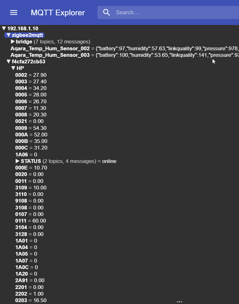

Actually since both Husdata and Domoticz (latest beta) now handles MQTT auto discovery it was pretty easy to install mqtt and enable it instead of the REST API that I used in the script previously.
There are two benefits of using MQTT instead of REST. The first one is that you do not have to bother with defining all the virtual sensors manually, which can be quite tedious and the second benefit is that as soon as there is any new data, it is sent directly to Domoticz instead of being polled at any given interval,
For installing Mosquitto follow the directions at https://mosquitto.org/blog/2013/01/mosq ... epository/. The only change I made was to use the bullseye version (which is the version I use for my Raspberry Pi)
sudo wget http://repo.mosquitto.org/debian/mosquitto-bullseye.list
Do not forget to add two lines into /etc/mosquitto/mosquitto.conf file and add:
listener 1883
allow_anonymous true
You will also have to restart Mosquitto or reboot your device in order for the changes to become active
sudo service mosquitto restart
or
sudo reboot
In the Hardware tab of Domoticz, choose MQTT Auto Discovery Client Gateway with LAN interface and add 127.0.0.1 in the Remote Address field.
In Husdata Config Menu, add the IP address of your Domoticz device to MQTT_SRVR, Set MQTT_DISCOV to 1 and if you would like to be able to change setpoint parameters, set MQTT_SUBS to 1 and reboot your H60.
It can be a good idea to install MQTT Explorer http://mqtt-explorer.com/ to see that Husdata is actually sending any parameters, but everything worked flawlessly and I automatically got 45 new devices, of which 8 were tunable parameters defined as "Thermostat", into Domoticz

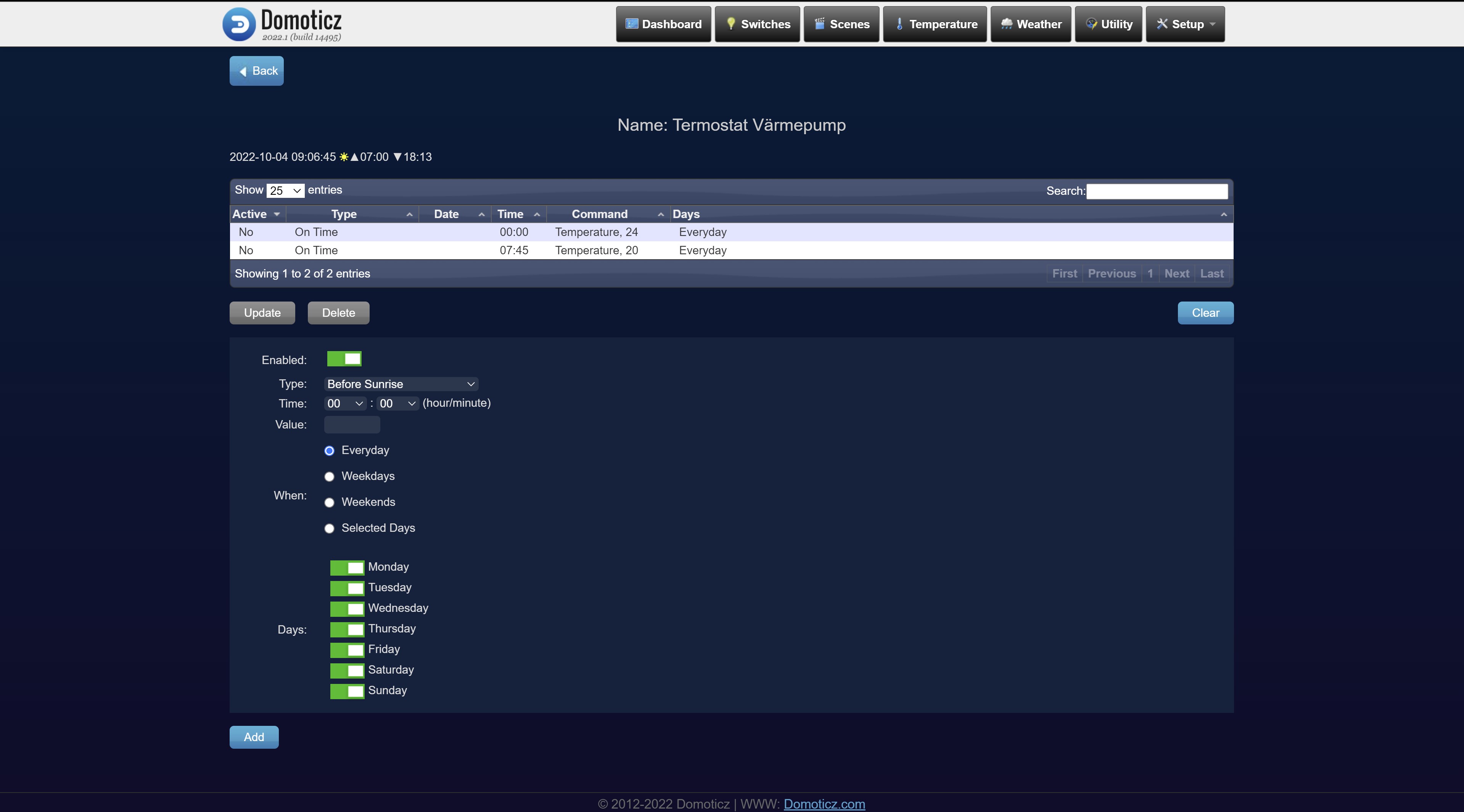

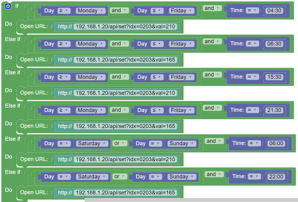

Now that electricity is very expensive in Sweden, I have started running with night reduction (lower room temperature) on the heat pump.
The disadvantage of the pump is that it is only possible to set a single control per heat source.
We have set the night lowering function so that the heat is switched on Monday - Sunday from 04:30 in the morning until 21:30 when the night lowering takes place. Then you cannot set more times and heating values ​​in the pump.
We would like to be able to set several schedules via Domoticz instead of in the heat pump.
We would like to be able to lower the temperature at a selectable time on the days when we are working during the day in order to save precious energy.
So I'm wondering if anyone can get me some help to creating a Lua script in DzVentz where you set the time for which temperature Domoticz Idx 2 "T_Room_temp_setpoint" and Husdata H60 Idx 0203 "Room temp setpoint" should be changed to.
E.g. Weekdays:
1. Heat in the house Monday - Friday from 04:30 - 06:00
2. Reduced heat in the house Monday - Friday from 06:00 - 16:00
3. Heating in the house Monday - Friday from 16:00 - 22:00
4. Reduced heat in the house Monday - Friday from 22:00 - 04:30
E.g. Weekends:
1. Heating in the house Saturday - Sunday from 07:00 - 22:00
2. Reduced heat in the house Saturday - Sunday from 22:00- 07:00

If you have created a "thermostat" as I did, you can define how many triggers you want in Domoticz.
In my case, I set it to 24 degrees at midnight and then to 20 degrees at 7.45 every day, but you can add an unique setpoint for each day if you want
Screenshot 2022-10-04 090858.jpg (380.72 KiB) Viewed 5179 times

I have done a script via Blockly as you can see in picture. This script also works very well.

But this solution is temporary until I have MQTT to work in Domoticz. All data sends from Husdata as you can see in picture from MQTT Explorer but this data will not come in to Domoticz. I don´t now whats going wrong....
Aqara sensors via ZigBee2MQTT works very well....
MQTT Data från HusData.png (39.44 KiB) Viewed 5151 times
Broker 1.5.7.png (11.2 KiB) Viewed 5151 times
So if you have some tips at MQTT ......

I just want to say that at MQTT from HusData to Domoticz works now..... Hurray!!!! :D
I have to remove text "Domoticz" in MQTT_PREFIX in HusData config´n, then all sensors come in to Domoticz.

Hi rogerthn.
I have one Bosch CR10 indoor thermostat in middle of plane 1 in our 2 plane house.
There is two tangential fans on plane 1, and two on plane 2 (wich we not use just now...)
As you can see in my Blockly script send this script URL-adress 192.168.1.20/api/set?idx=0203&val=200 or 192.168.1.20/api/set?idx=0203&val=165 specified times if day is Mondays to Fridays. Then same time check for Saturday and Sunday.
In this case is "val=165" = set room temp in heatpump to 165/10 = 16,5 degrees and so on.....
The "idx=0203" value in script is Husdata idx 0203 "Room temp setpoint" 16.50 C
Have a nice day!
