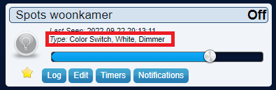

expering strange? behaviour with Shelly Dimmer 2 in Domoticz...
Used software and version:
Domoticz version 2022.1
Shelly MQTT https://github.com/enesbcs/Shelly_MQTT
DZGA Version: 1.10.9 master (DomoticZ Google Assistent) for integration between Domoticz and Google for voice controle
Setup:
Domoticz to integrate multiple hardware vendors and protocols, central home automation control, using smart metering P1, All kinds of Shelly devices, temperature (thermostat), security control, Airco Control, multimedia and weater integration.
Using Shelly MQTT to connect to Shelly devices (DImmer2, Shelly1, Shelly1PM, Shelly 2.5 (blinds control), Shelly Plug-S, etc.
DZGA is used for integration with Google Assistent.
Issue:
Shelly Dimmer2 devices appear in Domoticz as type "Color switch, white, dimmer" Within DZGA a Shelly Dimmer2 appears as "ColorSwitch": When looking at the MQTT based on "Zigbee2MQTT Plugin" https://github.com/stas-demydiuk/domoti ... issues/714 then a dimmer shows up as "Light/Switch" and not as "Color Switch".
The Shelly Dimmer2 can only dim lights and has no feature as Color Switch.
When doing a voice command to Google Assistent like "All lights on" this command will activate ALL devices with type "Light" AND "Color Switch", while ONLY should activate type "Light".
Does anyone has a solution for this?
Is it possible to show Shelly Dimmer2 as "Light/Switch" like is done with Zigbee2MQTT instead of "Color Switch"?
Why does Domoticz gets the device type "Color Switch"? Is this being caused by the Shelly MQTT plugin?
I hope somebody can help.

So I finally found the issue/error and with some help I managed to fix it!:
2 rows (line 1177+1178) need to be adjusted:
and 2 rows (1179 and 1180) need to be added after row 1178:
To all who are using the Shelly MQTT Python script of "enesbcs" and have issues with device type in Domoticz with a Shelly Dimmer2
Copy the code and paste(overwrite+ add) the code in the /domoticz/plugins/Shelly_MQTT/plugin.py file.
Save the file plugin.py file.
Remove the faulty devices in Domoticz
Quickly restart Domoticz service
After some time you will find the new created devices in the device tab with the correct device type "Light/Switch, Switch, Dimmer" instead of "Color Switch".
I tried to contact "enesbcs" but failed, I also tried to do a new pull request on GitHub, but this also failed because it is not supported.
