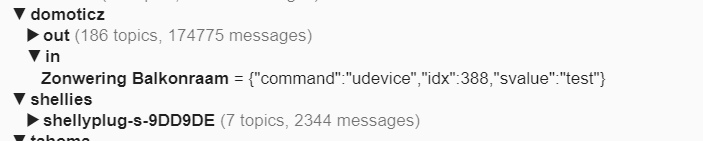

I've been able to post an MQTT message in the right folder:
2022-09-02 11_57_20-MQTT Explorer.png (9.27 KiB) Viewed 4411 times

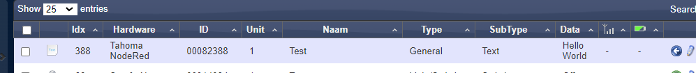

And added the dummy to domoticz:
2022-09-02 Domoticz.png (14.4 KiB) Viewed 4412 times
However, the data isn't showing up.
Any thoughts?

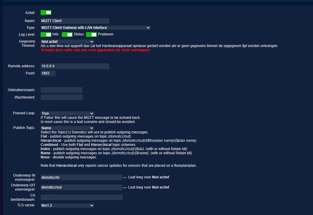

I think i did:
2022-09-02 13_48_01-domoticz.png (45.67 KiB) Viewed 4396 times
And i see the 'out' folder being filled nicely.

But before that, can you confirm, as I saw some issues in your screenshots, the following:
1. Your Domoticz is running with IP address 10.0.0.4. Running the default port 8080.
2. Your MQTT broker is using this IP address 10.0.0.4 as well with the default port 1883. Is it Mosquitto? See screenshot 02 Sep 2022, 13:50
3. In Domoticz you created a "Text" device, with IDX 388.

At least there is one thing, that is incorrect.
See your screenshot of MQTT Explorer (Your post of 02 Sep 2022, 11:56 ).
The JSON object you published ( {"command":"udevice", "idx":388,"svalue":"test"} ) has been published to the wrong topic and so Domoticz will never be able to handle it correctly.
The topic should be: domoticz/in and not domoticz/in/Zonwering Balkonraam

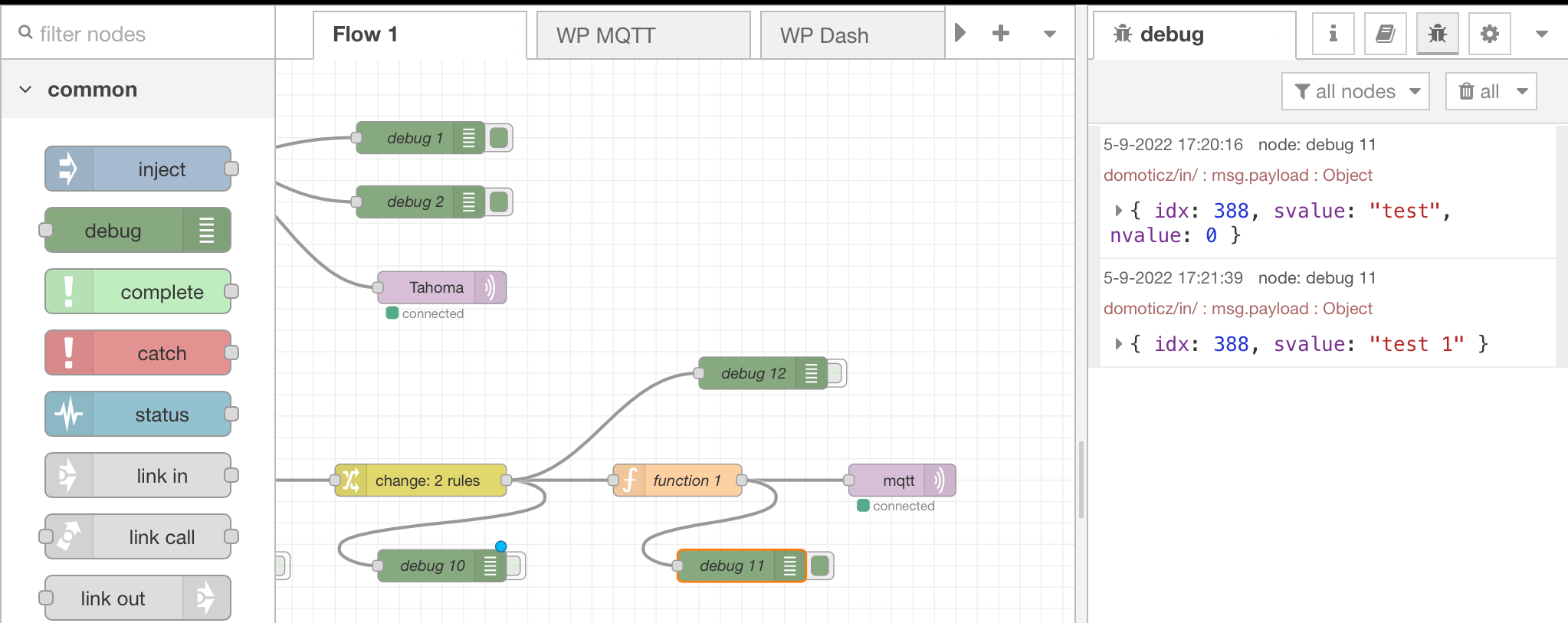

Hi @MikeyMan,
Can you send a screenshot of the output of the Debug Node, called "debug 11", at least if you use the latest Node Red release (3.0.2).
This is the Debug Node, connected to the Function node, called "function 1".
MikeyMan
Posts: 237
Joined: Wednesday 17 October 2018 12:11
Re: Cant get MQTT output into domoticz
Post by MikeyMan »
FireWizard wrote: Monday 05 September 2022 11:21 Hi @MikeyMan,
Here you go:
Took removal of the time stamp out.
Writing value to text with JSON succeeded. Even remotely ;)
Still no luck from nodered though.
 [{"id":"743a62898f598be4","type":"tab","label":"Flow 1","disabled":false,"info":"","env":[]},{"id":"aba1dab9e8709847","type":"http request","z":"743a62898f598be4","name":"Get Version","method":"GET","ret":"obj","paytoqs":"ignore","url":"https://10.0.0.199:8443/enduser-mobile-web/1/enduserAPI/apiVersion","tls":"d141c56ce52dcd5d","persist":false,"proxy":"","insecureHTTPParser":false,"authType":"bearer","senderr":false,"headers":[],"x":610,"y":120,"wires":[["d58a15c4c09ebd12","9c0b16ffc945e95a","8690d30946cad6ca"]]},{"id":"d58a15c4c09ebd12","type":"debug","z":"743a62898f598be4","name":"debug 1","active":true,"tosidebar":true,"console":false,"tostatus":false,"complete":"true","targetType":"full","statusVal":"","statusType":"auto","x":900,"y":100,"wires":[]},{"id":"9c0b16ffc945e95a","type":"debug","z":"743a62898f598be4","name":"debug 2","active":true,"tosidebar":true,"console":false,"tostatus":false,"complete":"payload.protocolVersion","targetType":"msg","statusVal":"","statusType":"auto","x":900,"y":160,"wires":[]},{"id":"1c61a2e3f17004cc","type":"inject","z":"743a62898f598be4","name":"","props":[{"p":"payload"},{"p":"topic","vt":"str"}],"repeat":"","crontab":"","once":false,"onceDelay":0.1,"topic":"","payload":"","payloadType":"date","x":320,"y":120,"wires":[["aba1dab9e8709847"]]},{"id":"8690d30946cad6ca","type":"mqtt out","z":"743a62898f598be4","name":"","topic":"Tahoma","qos":"","retain":"","respTopic":"","contentType":"","userProps":"","correl":"","expiry":"","broker":"92e5b2c.00a8b5","x":920,"y":240,"wires":[]},{"id":"fc6d9990e9735efe","type":"http request","z":"743a62898f598be4","name":"Get Devices","method":"GET","ret":"obj","paytoqs":"ignore","url":"https://10.0.0.161:8443/enduser-mobile-web/1/enduserAPI/setup/devices","tls":"d141c56ce52dcd5d","persist":true,"proxy":"","insecureHTTPParser":false,"authType":"bearer","senderr":false,"headers":[],"x":430,"y":420,"wires":[["792793a85f7af9e3","0f5c255927c3a287"]]},{"id":"0d0b145a46d08eb6","type":"inject","z":"743a62898f598be4","name":"","props":[{"p":"payload"},{"p":"topic","vt":"str"}],"repeat":"","crontab":"","once":false,"onceDelay":0.1,"topic":"","payload":"","payloadType":"date","x":220,"y":420,"wires":[["fc6d9990e9735efe"]]},{"id":"27bcb8ebe2e66553","type":"mqtt out","z":"743a62898f598be4","name":"","topic":"","qos":"","retain":"","respTopic":"","contentType":"","userProps":"","correl":"","expiry":"","broker":"92e5b2c.00a8b5","x":1350,"y":420,"wires":[]},{"id":"14b2125b610f82a3","type":"debug","z":"743a62898f598be4","name":"debug 8","active":false,"tosidebar":true,"console":false,"tostatus":false,"complete":"payload.label","targetType":"msg","statusVal":"","statusType":"auto","x":700,"y":500,"wires":[]},{"id":"792793a85f7af9e3","type":"debug","z":"743a62898f598be4","name":"debug 9","active":false,"tosidebar":true,"console":false,"tostatus":false,"complete":"payload","targetType":"msg","statusVal":"","statusType":"auto","x":480,"y":500,"wires":[]},{"id":"390f410fdeae6dec","type":"change","z":"743a62898f598be4","name":"","rules":[{"t":"set","p":"topic","pt":"msg","to":"\"domoticz/in/\"","tot":"jsonata"},{"t":"delete","p":"payload.creationTime","pt":"msg"}],"action":"","property":"","from":"","to":"","reg":false,"x":900,"y":420,"wires":[["0d414e1eda85b389","164e4e3ca1fddfca","1f4ca39d34a2136f"]]},{"id":"0d414e1eda85b389","type":"debug","z":"743a62898f598be4","name":"debug 10","active":false,"tosidebar":true,"console":false,"tostatus":false,"complete":"topic","targetType":"msg","statusVal":"","statusType":"auto","x":920,"y":500,"wires":[]},{"id":"0f5c255927c3a287","type":"split","z":"743a62898f598be4","name":"","splt":"\\n","spltType":"str","arraySplt":1,"arraySpltType":"len","stream":false,"addname":"","x":670,"y":420,"wires":[["14b2125b610f82a3","390f410fdeae6dec"]]},{"id":"164e4e3ca1fddfca","type":"function","z":"743a62898f598be4","name":"function 1","func":"//if(msg.payload.deviceURL === \"io://2017-8871-5701/3196925\")\n//{\n//    return msg;\n//}\n\nif (msg.payload.deviceURL === \"io://2017-8871-5701/3196925\") \n    {\n    msg.payload = { \"idx\": 388, \"svalue\": \"test 1\" } \n  //  msg.topic = { \"domoticz/in\" }\n    return msg;\n    }\n\n\n//{ \"command\": \"udevice\", \"idx\" : 7, \"nvalue\" : 0, \"svalue\" : \"90;2975.00\" }\n//{ \"idx\" : 7, \"nvalue\" : 0, \"svalue\" : \"90;2975.00\" }\n\n","outputs":1,"noerr":0,"initialize":"","finalize":"","libs":[],"x":1140,"y":420,"wires":[["27bcb8ebe2e66553","5569758a44d2d493"]]},{"id":"5569758a44d2d493","type":"debug","z":"743a62898f598be4","name":"debug 11","active":true,"tosidebar":true,"console":false,"tostatus":false,"complete":"payload","targetType":"msg","statusVal":"","statusType":"auto","x":1200,"y":500,"wires":[]},{"id":"1f4ca39d34a2136f","type":"debug","z":"743a62898f598be4","name":"debug 12","active":false,"tosidebar":true,"console":false,"tostatus":false,"complete":"payload","targetType":"msg","statusVal":"","statusType":"auto","x":1220,"y":320,"wires":[]},{"id":"d141c56ce52dcd5d","type":"tls-config","name":"TLS","cert":"","key":"","ca":"","certname":"","keyname":"","caname":"","servername":"","verifyservercert":false,"alpnprotocol":""},{"id":"92e5b2c.00a8b5","type":"mqtt-broker","name":"MQTT (NAS)","broker":"10.0.0.4","port":"1883","clientid":"Node_Red_Client","autoConnect":true,"usetls":false,"compatmode":false,"protocolVersion":"4","keepalive":"60","cleansession":true,"birthTopic":"","birthQos":"0","birthRetain":"false","birthPayload":"","birthMsg":{},"closeTopic":"","closeQos":"0","closeRetain":"false","closePayload":"","closeMsg":{},"willTopic":"","willQos":"0","willRetain":"false","willPayload":"","willMsg":{},"userProps":"","sessionExpiry":""}]

Hello @MikeyMan
As I see the output is correct and so should display the text "test" and "test 1" respectively, if at least the sensor with idx 388 is a "Text" sensor.
That should work and this text string has been sent by the MQTT output node of your Node Red flow.
So I do not understand
On 05 Sep 2022, 17:43 you wrote:
And this is working somehow.
Well does it work or not. You should see the text "test" and "test 1" The word "somehow" does not make it clearer.
You wrote also:
Seems that the switch node is the culprit?
So it is time to look at the output of the API call.
Can you show the output of "debug 9"?

Thing is, when I enter the topic manually in the mqtt output node, it is working. When I replace the msg.topic in the change node, it doesn't. So might be I wasn't using that in the right way, although the output looked correct in mqtt explorer.
Don't know what the difference between these two is. In the screenshot, the output of the debug node looks slightly different.
As you can see from the NodeRed JSON, I'm not really using the API call yet. That's the next step, now that output is showing up in domoticz :)
