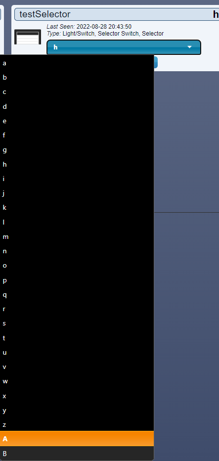

if a selector has more than 25 levels, when you use the 26, 27, the state is empty
Screenshot 2022-08-28 204506.png (26.78 KiB) Viewed 451 times

	on =    {
		devices = {1266},
	logging = {level =  domoticz.LOG_DEBUG},
	execute = function(dz, item)
        dz.log(item.name .. ' <' .. item.state .. '>', dz.LOG_DEBUG)
        if  item.state < ' ' then
            dz.log(item.name .. ' state KO ' .. item.rawData[1], dz.LOG_DEBUG)
            dz.log(item.name .. ' state OK ' .. item.rawData[1], dz.LOG_DEBUG)
click on y
022-08-28 20:50:09.558 Status: dzVents: Info: ------ Start internal script: Z_Selector: Device: "testSelector (Dummy)", Index: 1266
2022-08-28 20:50:09.558 Status: dzVents: Debug: testSelector <y>
2022-08-28 20:50:09.558 Status: dzVents: Debug: testSelector state OK 250
2022-08-28 20:50:09.558 Status: dzVents: Info: ------ Finished Z_Selector
click on z
2022-08-28 20:51:06.447 Status: dzVents: Info: Handling events for: "testSelector", value: ""
2022-08-28 20:51:06.448 Status: dzVents: Info: ------ Start internal script: Z_Selector: Device: "testSelector (Dummy)", Index: 1266
2022-08-28 20:51:06.448 Status: dzVents: Debug: testSelector <>
2022-08-28 20:51:06.448 Status: dzVents: Debug: testSelector state KO 4
2022-08-28 20:51:06.448 Status: dzVents: Info: ------ Finished Z_Selector
2022-08-28 20:51:06.869 Status: dzVents: Info: Handling events for: "testSelector", value: ""
2022-08-28 20:51:06.869 Status: dzVents: Info: ------ Start internal script: Z_Selector: Device: "testSelector (Dummy)", Index: 1266
2022-08-28 20:51:06.869 Status: dzVents: Debug: testSelector <>
2022-08-28 20:51:06.869 Status: dzVents: Debug: testSelector state KO 24
2022-08-28 20:51:06.870 Status: dzVents: Info: ------ Finished Z_Selector
