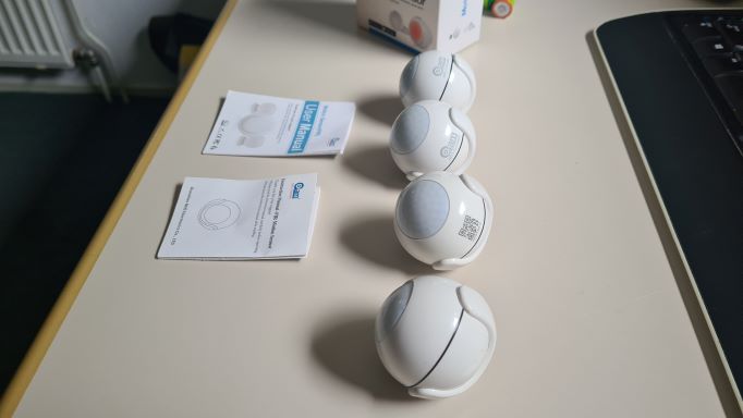

Recently I bought 4 additional second hand Z-Wave PIRs of Marktplaats (Dutch eBay). I was able to add one immediately, but the other 3 do not get paired at all. So, the gateway doesn't see the devices. Main issue here is that I don't know how to put them in inclusion mode.
If I hold the button for 10 seconds the LED doesn’t blink like I see in the online manuals.
The three that don’t connect have a QR code on the side, the one that does work doesn’t. If I scan the QR code it only displays a code. These three codes are: 0A20130212, 0A20178B27, 0A2015CB29
If I press the button once the LED lights up for about 5 seconds and then is off again.
If I quickly press the button 3 times the exact same thing happens.
If I press and hold the button it liights up. After 5 seconds it turns off and immediately lights up again (as I am holding the button of course). Then nothing happens.
Tried inserting the battery while pressing and holding the button.
If it detects movement it blinks twice.
The one that I could add just started blinking after pressing the button 3 times indicating it is in inclusion mode.
Now Neo Coolcam has 4 versions of the PIRs and they have (I think) Z-Wave, Zigbee and WiFi versions of these.
I have the Tuya app on my phone and tried adding them to Tuya, perhaps this person has sent me WiFi versions. But that didn't work.
I received the four sensors in one box and it included two different user manuals. I have added two pictures with the three that I cannot connect on the left and the one that I can connect on the right.
Could you please help me? Are these Z-Wave devices? How do I add them to my gateway? How can I reset them to factory defaults?

Hi, they have the Z-Wave logo.
So in that case set Domoticz in inclusion mode and click 3 times on the button within the sensor.
You have to do that quickly within 1,5 second.

Thanks for getting back to me so soon. Perhaps I wasn't quick enough with pressing the button. Will try another few times.
However, where do you see the Z-Wave logo? If you're referring to the box, that's the box in which all four devices were sent to me. I think they took the box in which they received the one that is truly Z-Wave and does work

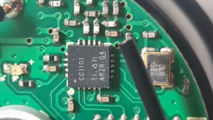

In the meantime I have opened up one of them. I see a CC1101 chip.
20220819_113235 a.jpg (45.79 KiB) Viewed 981 times
If I Google it, I find 868Mhz and 433Mhz results.
