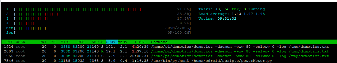

Yesterday I saw that one domoticz process is 100 CPU usage. So I need find what script is taking high resources. If dzvent is disable this high process is going down to normal values.

I have 42 dzvents scripts, may be it is a lot of work to script engine??

I solved my problem
I had undervoltage and cpu clock was fixed at 700mhz... Once undervoltage has been solved cpu is going 1.5ghz and all works fine.
