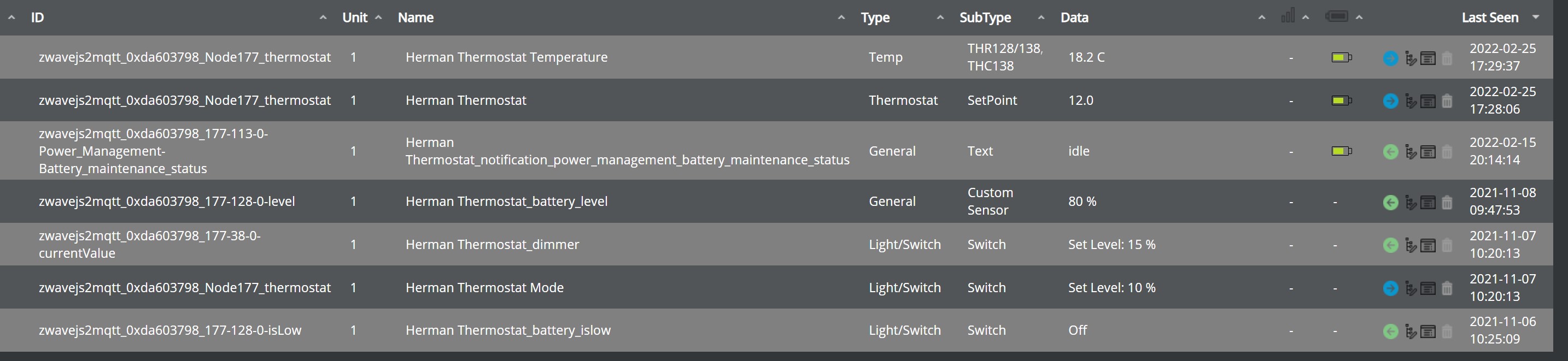

Re: zwavejs2mqtt
Here's mine. It has a weird 'dimmer' device that I just hide and ignore. So far, it works quite fine for me but then I don't do very special stuff.

Re: zwavejs2mqtt
Thanks. So it wont work for me because the level device is missing.

Re: zwavejs2mqtt
Sorry, I was wrong. The thermostat dimmer seems to be the device.

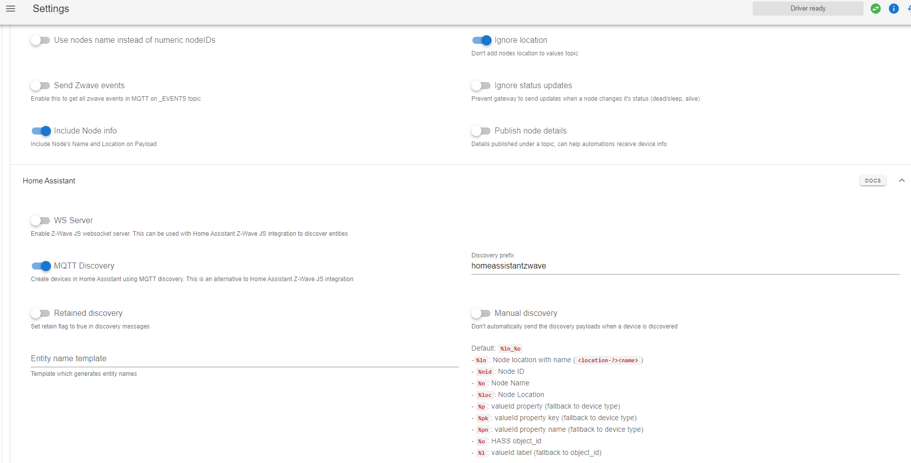

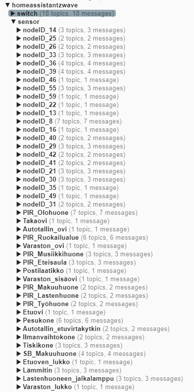

Hi again. I wonder which setting is off in my zwavejs2mqtt config. I am now repeatedly getting new devices created in Domoticz from zwave nodes that have been completely removed and not visible in zwavejs2mqtt. I am also getting very weird devices like air temperature for fibaro plug. These are created at Domoticz start and do not update after that. I guess some flags are incorrect in the mqtt, gateway or homeassistant section...?
Relevant earlier posts with regards to my initial struggles to get it working:
Nautilus wrote: Tuesday 28 December 2021 14:41 ...
edit. I turned the "retained discovery" switch on in zwavejs2mqtt to "on" and now I have the nodes back under discovery topic. Not sure if this is the rights way to do as it was mentioned to best to keep it off...
Nautilus wrote: Tuesday 04 January 2022 9:42 All in all I have to say I'm very impressed about some of the changes with regards to stability and overall functionality observed now after running zwavejs2mqtt together with Domoticz for about a week. Maybe someone can help me with one question. Initially when zwavejs2mqtt discovers the devices, they do not have a name (of course). After adding some names, I noticed the devices stopped working in Domoticz (sort of - some did, most did not).
I configured zwavejs2mqtt with the help of these recommendations:
https://github.com/moroen/ZWave-MQTT-pl ... avejs2mqttBut as mentioned couple of posts above:Gateway configuration:
Use node names instead of numeric nodeIDs: Off
Ignore location: On
Include Node Info: On
Note: Specifying node names and locations in zwavejs2mqtt is not required, but recommended. This will generate somewhat sane names of the devices when they are added to domoticz.So my retained flag was on. I took it off and everything started working again. I thought this was it. But then I needed to do one more change and when testing the device in Domoticz after the change, it did not work right away. And I'm not fully sure what I did to make it start working againNow, when I look at the topics in mqtt explorer, I can see only one ID under discovery node, yesterday I saw several of them. I can see them under zwave node though. Why have they disappeared from discovery? Can it be the fact that I enable OZW for a while to get my old device names? Since then I've restarted the system and everything so shouldn't it recover? Can I force the discovery topics to be populated somehow again?
edit. I turned the "retained discovery" switch on in zwavejs2mqtt to "on" and now I have the nodes back under discovery topic. Not sure if this is the right way to do as it was mentioned to best to keep it off...
Now I wonder which is the best practice to change device name in zwavejs2mqtt and keep everything working in Domoticz. Is it just this:So do I need to save preferences once after each name update to re-generate status messages? Or something else?Hint: To add all devices at once, enable the plugin in domoticz, and press "Save" in zwavejs2mqtt preferences. This will generate status messages for all devices.

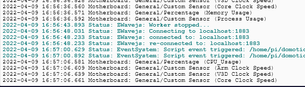

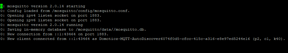

so after some struggle with this whole docker and mosquitto conif I'm now facing an issue I can't resolve by myself.
I think domoticz is connectet with mqtt but no devices are created.
This is the mosquitto log: And this the domoticz log: And thats it. No more logs regarding zwavejs2mqqt on both sides.
MQTT Discorvery is activated in zwavejs2mqtt config.
Help is greatly appreciated.Thanks
EDIT: Okay, just after submit this post I remembered that there is a third party.
This is the zwavejs log: But why it cannot connect?

If using docker I think you need to use the actual IP of the device rather than "localhost". That could cause connection issues.

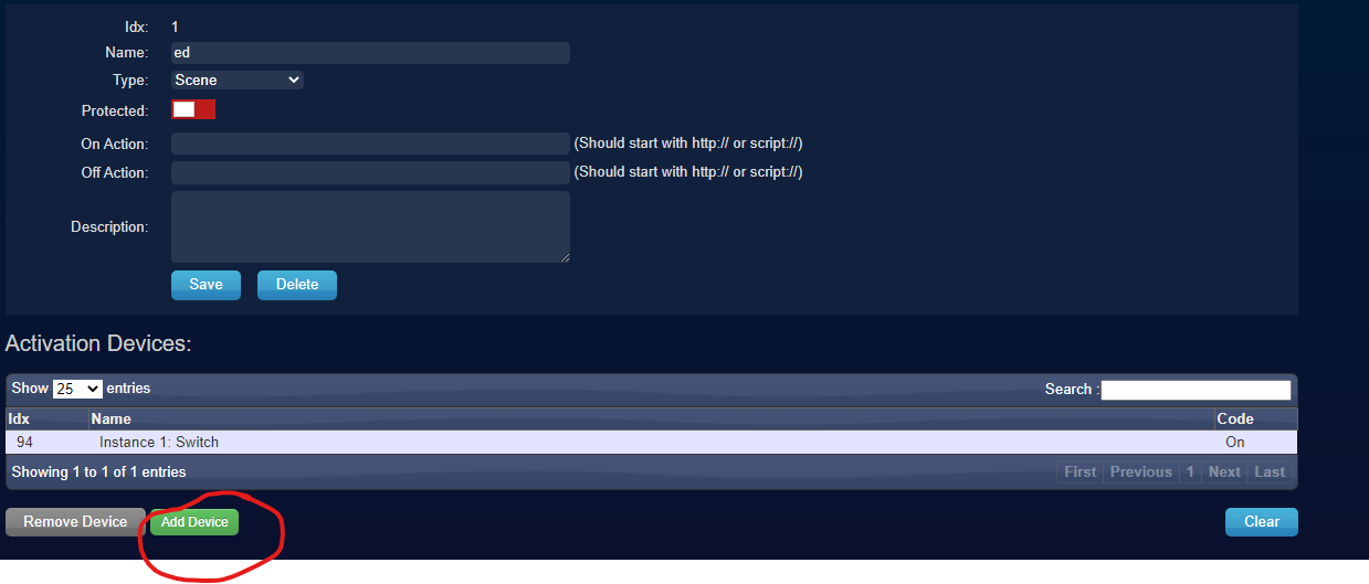

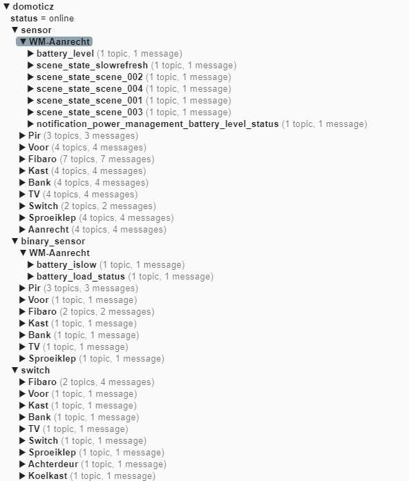

I have an issue adding the Wallmote Quad ZW130.
Adding this wireless switch to domoticz using autodiscover Zwavejs2mqtt the scene selector (4 switches) are added as general Custom sensor.
In OZW they are added as Light/Switch Switch.
Using the MQTT explorer i see this Wallmote (WM Aanrecht) is added as sensor and binary sensor in stead of as switch.
Anyone can help me out how to configure the wallmote to switch scenes ?

Nautilus wrote: Monday 04 April 2022 10:27 Hi again. I wonder which setting is off in my zwavejs2mqtt config. I am now repeatedly getting new devices created in Domoticz from zwave nodes that have been completely removed and not visible in zwavejs2mqtt...
Strange saga with zwavejs2mqtt continues. After adjusting the config with recommended settings, I have found the platform to be stable for few weeks. But since yesteday (or Domoticz restart at night, not sure) I have been experiencing weird issues. Switches did not function when set from Domoticz, when set from zwavejs2mqtt they worked. I went to debug and e.g. when trying to open my Danalock lock I saw message:
Message received on zwave/Etuoven_lukko/98/0/targetMode/set: '0'
Etuoven_lukko (front door lock) is the friendly name of the device. Nothing happened with the lock. Then I'm not sure what I exactly did next but at least I save the zwavejs2mqtt config, deleted few unused nodes with mqtt explorere that keeps reappearing even though they are not in zwavejs2mqtt anymore. Then suddenly the switches started working again from Domoticz. Now if I look what happens with the same lock, I see:
Message received on zwave/46/98/0/targetMode/set: '0'
So it is again using the node id. What in Domoticz controls this? Why did it change in the first place and what prompted it to change back?
edit: I tested by deleting all friendly name topics, when I press "Save" in zwavejs2mqtt I get the friendly name topics back, is this expected:

Re: zwavejs2mqtt
Using Open Zwave the buttons of the wallmote will be recognized as switch after adding them to a scene where you press the add device button, preass the button on the wallmote (in this case button 1). And then in the device list it is listed as a switchPietjePuck wrote: Tuesday 12 April 2022 15:47 I have an issue adding the Wallmote Quad ZW130.
- Device showed up ad switch
- Screenshot 2022-04-26 155227.png (5.04 KiB) Viewed 4247 times
- Adding button to scene
- Screenshot 2022-04-26 155014.png (49.61 KiB) Viewed 4247 times

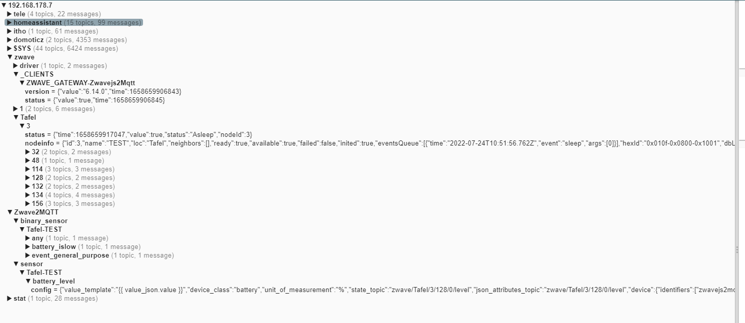

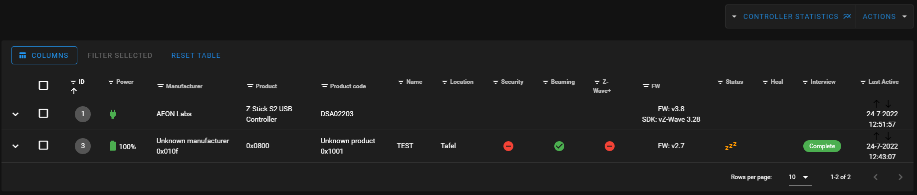

I am testing this zwave2MQTT and managed to get the control panel running, am able to include a device and in domoticz the auto discovery function is addin the included devices. But I have some trouble with the following:
The device I included is a Fibaro FGMS001 motion sensor. In the control panel it is not recognized because in the manufacturer column it says "Unknown manufacturer 0x010f". I also am missing some functions for instance the lux measurement. The strange thing is that when I open the link next to the device ID it goes to the zwave JS database where the FGM001 is listed. So it seems the FGMS001 is in the database but still not recognized. Excluding and including it again gives the same result.
The MQTT explorer shows the FGMS001 (I named it "TEST" and gave it the location "Tafel".
Maybe the next is related to the above but the values of the device are not updated, not in the control panel (i'm not sure where I can see the values?) and also not updated in Domoticz.
