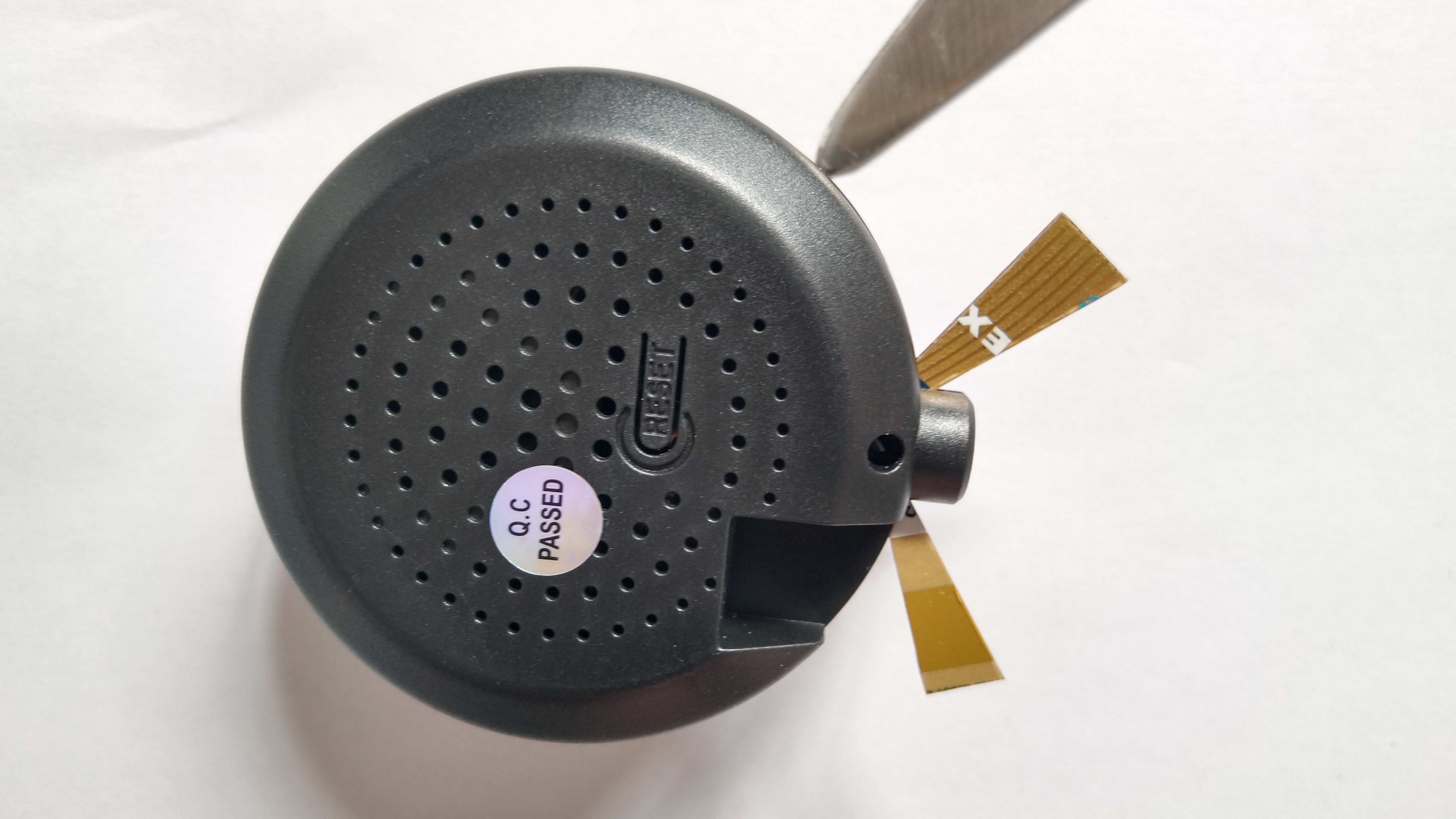

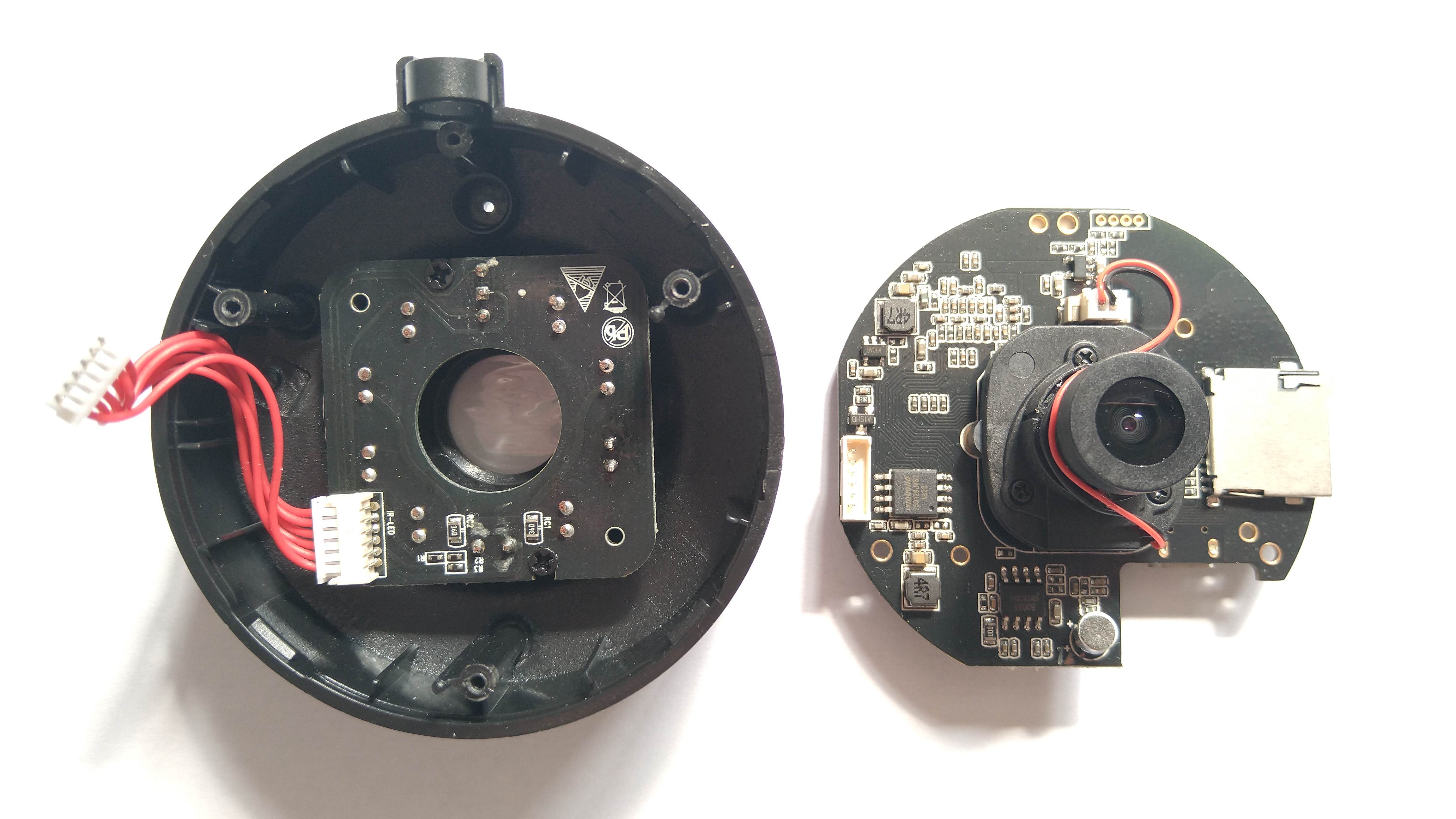

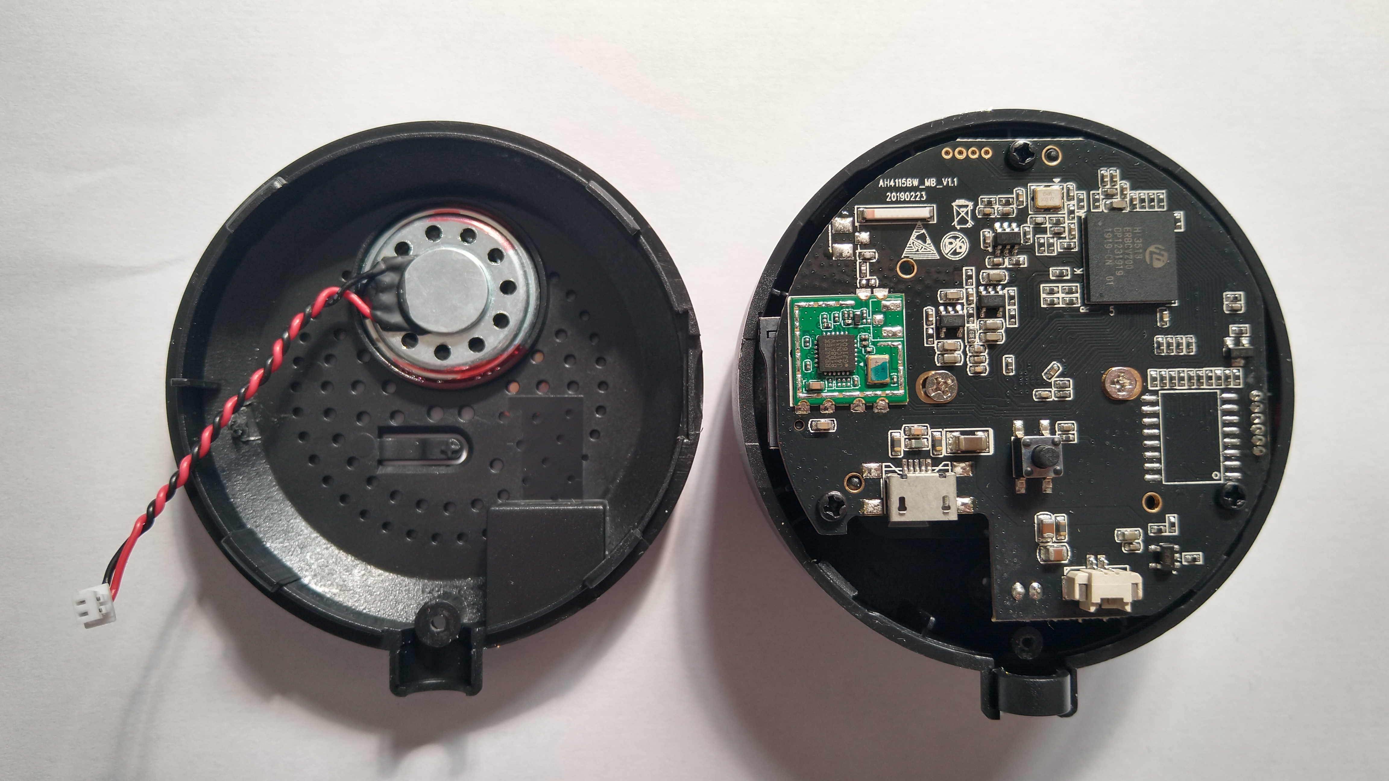

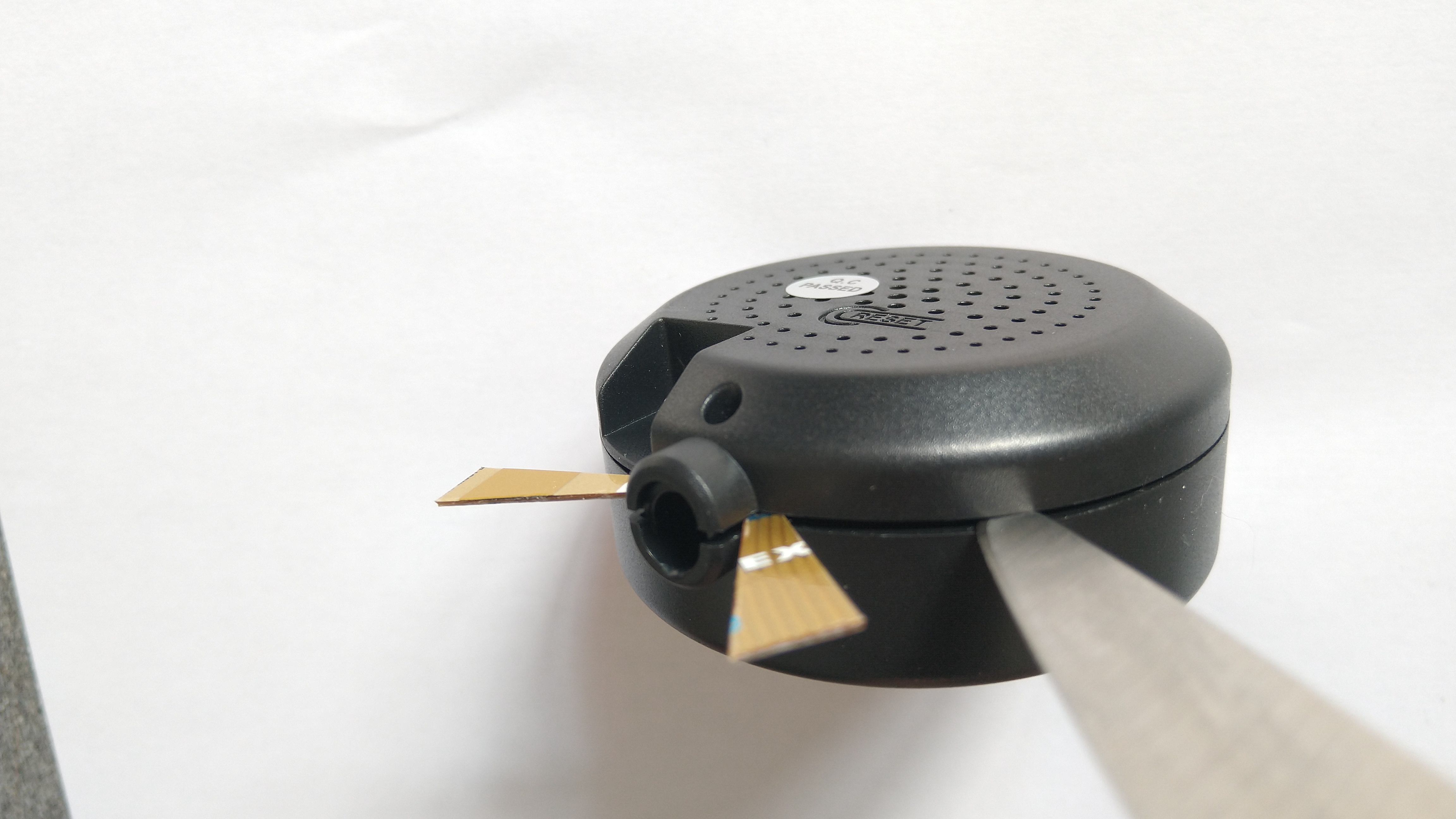

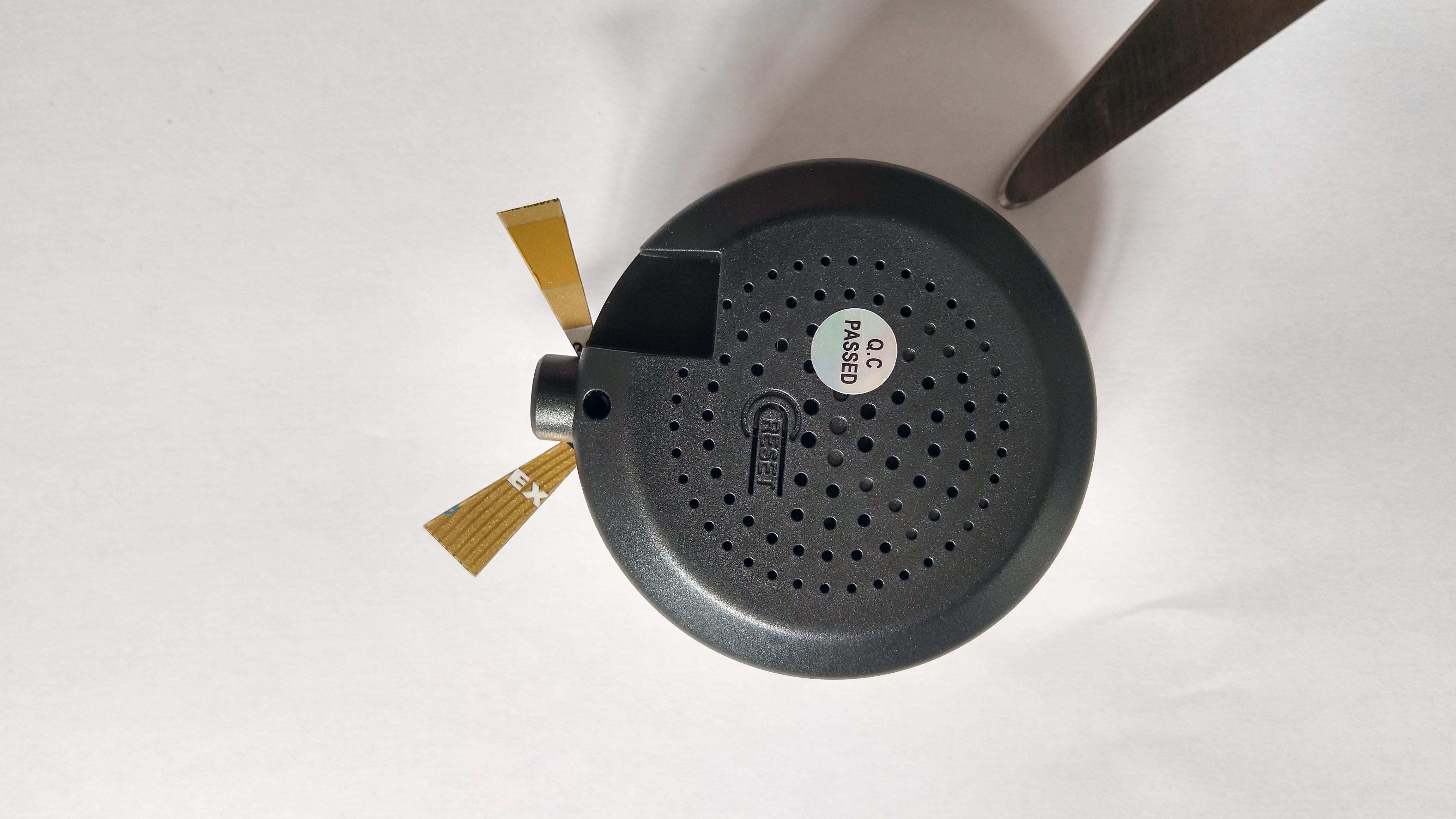

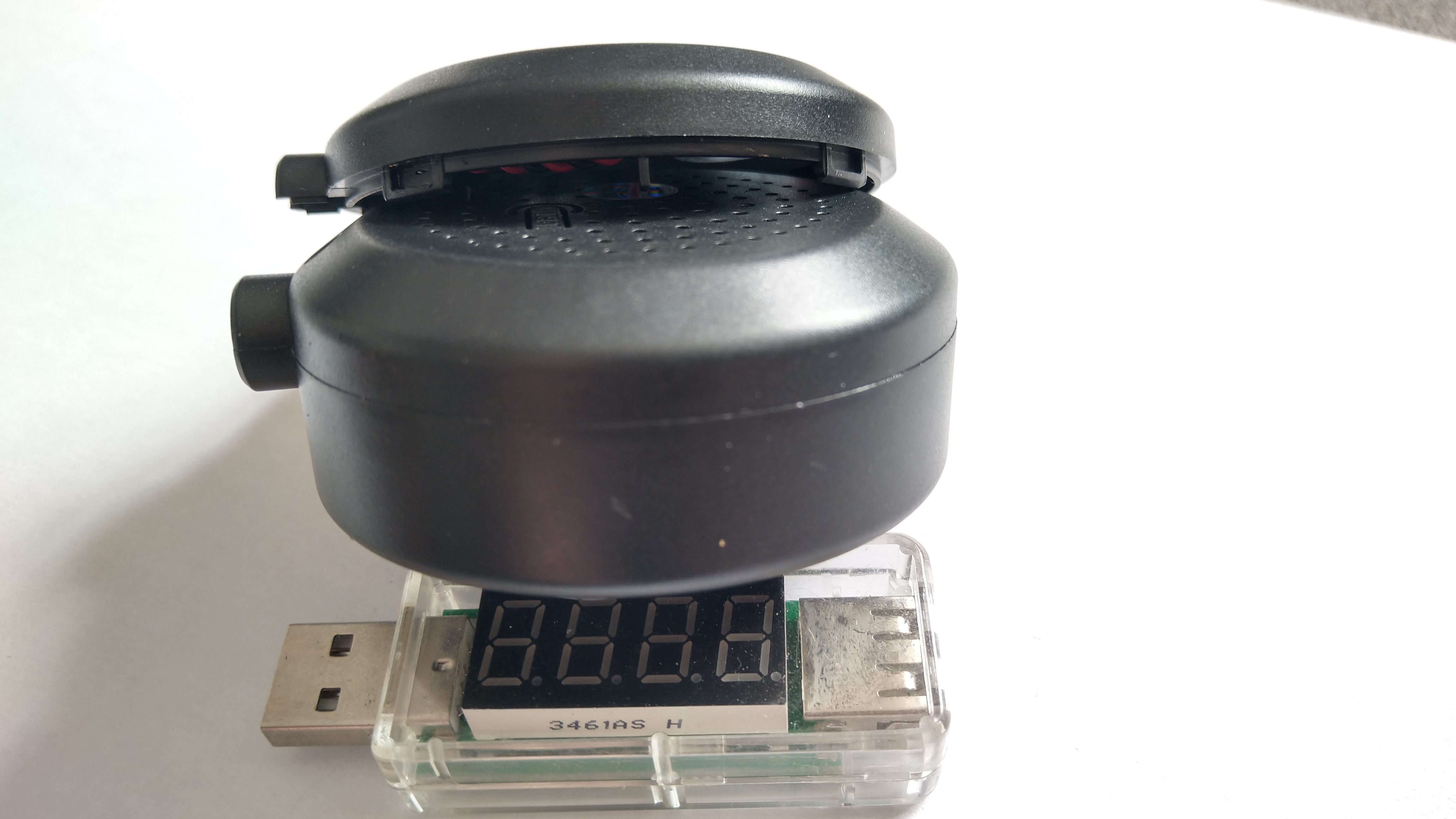

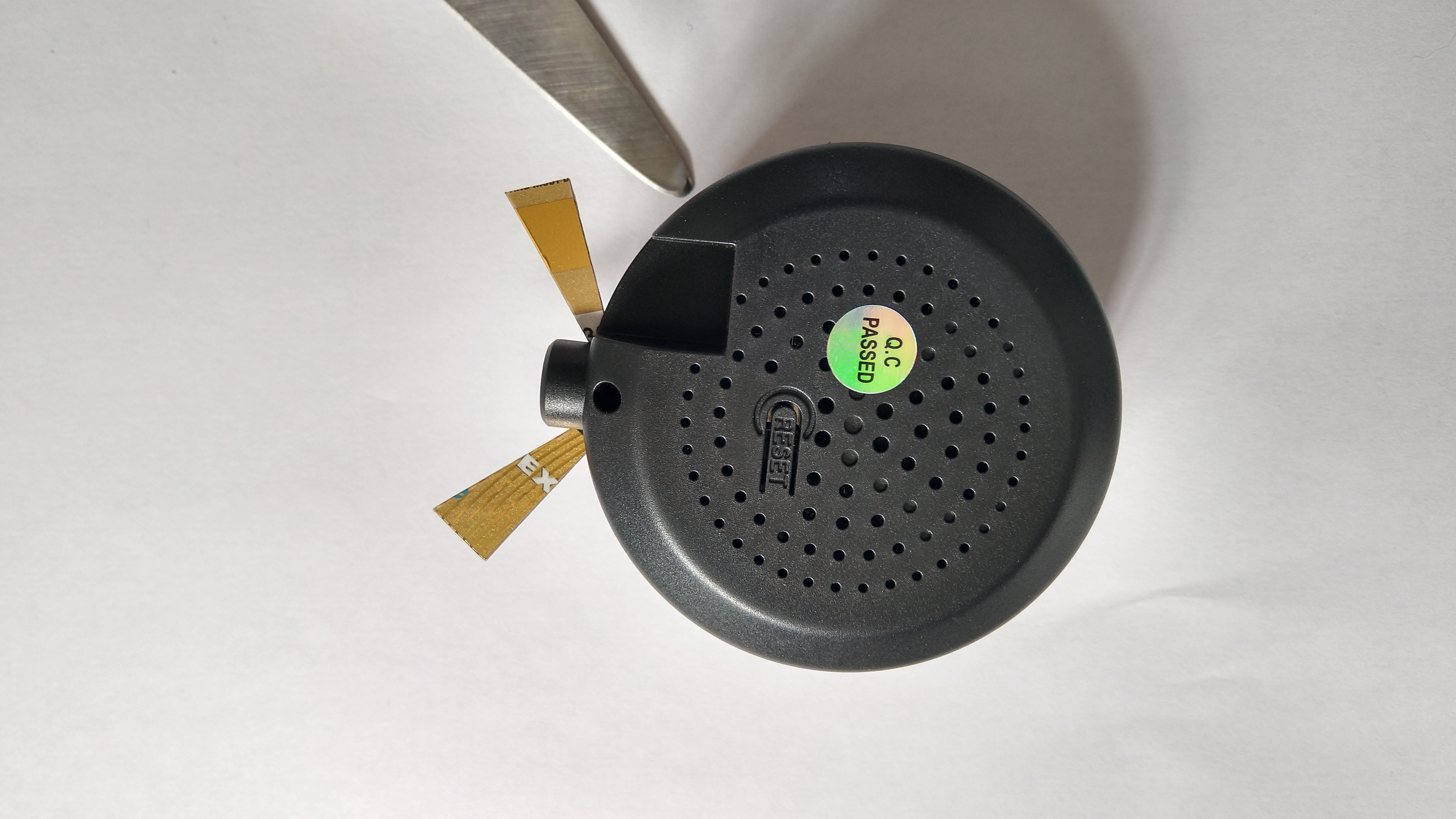

I bought a Smartwares CIP-37210 WiFi camera and now looking for an opportunity to gain access to the operating system.
Consists of:
SoC HiSilicon 3518EV200
WiFi Realtek 8188FTV
Flash Winbond 25Q128JVSQ
SD-card reader
microphone
speaker
Pictures:
