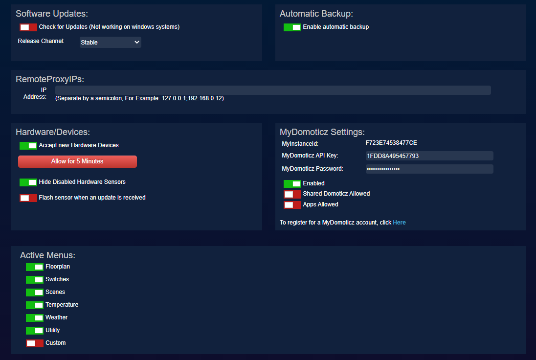

The devices are not appearing although I have been to "settings, allow new new hardware devices" several times.
I also clicked on "allow joins" in case it would have some useful effect. I have no idea what it is supposed to do.

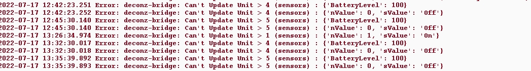

The error log shows Any idea what I am doing wrong? What incorrect settings might be allowing me to get this far but no further?

Thoses device are probably in the plugin database because you don't have the error message
Can you enable loging in the hardware page "debug info only", you will have more usefull lines around the red one (but not error status)
Can you check direclty in the API what is the sensor 4 exemple ? and show me the device json ?
Can use the frontend in custom / deconz, or Phoscon/help/API INformation/sensors/ 4
When you restart the plugin, domoticz resynchronise all the zigbee devices, perhaps you have usefull logs at this moment too. For me the issue start here, the plugin list all zigbee device, add them to the plugin database but not in domoticz, but why ....
But the plugin can't find them in domoticzWebsocket error, unknown device >

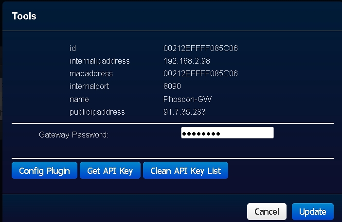

Well I only have the two water alarm sensors but the default daylight sensor is still listed. I will delete that.
Anyhow this is the Tools window. This is what is in the config plugin

2022-07-17 19:12:09.124 Error: (deconz-bridge) Device creation failed, Domoticz settings prevent accepting new devices.
2022-07-17 19:12:09.126 Error: deconz-bridge: Can't Update Unit > 1 (sensors) : {'nValue': 1, 'sValue': 'On'}
2022-07-17 19:12:09.127 Error: (deconz-bridge) Device creation failed, Domoticz settings prevent accepting new devices.
2022-07-17 19:12:09.127 Error: deconz-bridge: Can't Update Unit > 4 (sensors) : {'nValue': 0, 'sValue': 'Off', 'BatteryLevel': 100}
2022-07-17 19:12:09.127 Error: deconz-bridge: Can't Update Unit > 5 (sensors) : {'nValue': 0, 'sValue': 'Off', 'BatteryLevel': 100}
2022-07-17 19:12:19.060 deconz-bridge: onHeartbeat called
Should I reset everything and start again? Could it be that I am using the incorrect internal port?

And this is the logging.
2022-07-17 19:12:09.123 deconz-bridge: Request Return: {"1":{"config":{"configured":true,"on":true,"sunriseoffset":30,"sunsetoffset":-30},"etag":"9f6ece548a2c48a99dac161a1b53ac0b","manufacturername":"Philips","modelid":"PHDL00","name":"Daylight","state":{"dark":false,"daylight":true,"lastupdated":"2022-07-17T11:26:34.934","status":170,"sunrise":"2022-07-17T03:38:23","sunset":"2022-07-17T19:14:33"},"swversion":"1.0","type":"Daylight","uniqueid":"00:21:2e:ff:ff:08:5c:06-01"},"4":{"config":{"battery":100,"enrolled":5,"on":true,"pending":[],"reachable":true,"temperature":2800},"ep":1,"etag":"8190b970c5105bd28af7dece3f33bb8f","lastannounced":null,"lastseen":"2022-07-17T16:33Z","manufacturername":"LUMI","modelid":"lumi.sensor_wleak.aq1","name":"Water Sensor Kitchen","state":{"lastupdated":"2022-07-17T16:33:04.698","lowbattery":false,"tampered":false,"water":false},"swversion":"20200310","type":"ZHAWater","uniqueid":"00:15:8d:00:08:08:f4:29-01-0500"},"5":{"config":{"battery":100,"enrolled":6,"on":true,"pending":[],"reachable":true,"temperature":3100},"ep":1,"etag":"42f524f4ddbe272e584cc85c27e6c23e","lastannounced":"2022-07-17T09:54:21Z","lastseen":"2022-07-17T16:36Z","manufacturername":"LUMI","modelid":"lumi.sensor_wleak.aq1","name":"Water Sensor Cellar","state":{"lastupdated":"2022-07-17T16:36:18.926","lowbattery":false,"tampered":false,"water":false},"swversion":"20200310","type":"ZHAWater","uniqueid":"00:15:8d:00:08:08:ec:33-01-0500"}}
2022-07-17 19:12:09.124 deconz-bridge: Classic Data : {'1': {'config': {'configured': True, 'on': True, 'sunriseoffset': 30, 'sunsetoffset': -30}, 'etag': '9f6ece548a2c48a99dac161a1b53ac0b', 'manufacturername': 'Philips', 'modelid': 'PHDL00', 'name': 'Daylight', 'state': {'dark': False, 'daylight': True, 'lastupdated': '2022-07-17T11:26:34.934', 'status': 170, 'sunrise': '2022-07-17T03:38:23', 'sunset': '2022-07-17T19:14:33'}, 'swversion': '1.0', 'type': 'Daylight', 'uniqueid': '00:21:2e:ff:ff:08:5c:06-01'}, '4': {'config': {'battery': 100, 'enrolled': 5, 'on': True, 'pending': [], 'reachable': True, 'temperature': 2800}, 'ep': 1, 'etag': '8190b970c5105bd28af7dece3f33bb8f', 'lastannounced': None, 'lastseen': '2022-07-17T16:33Z', 'manufacturername': 'LUMI', 'modelid': 'lumi.sensor_wleak.aq1', 'name': 'Water Sensor Kitchen', 'state': {'lastupdated': '2022-07-17T16:33:04.698', 'lowbattery': False, 'tampered': False, 'water': False}, 'swversion': '20200310', 'type': 'ZHAWater', 'uniqueid': '00:15:8d:00:08:08:f4:29-01-0500'}, '5': {'config': {'battery': 100, 'enrolled': 6, 'on': True, 'pending': [], 'reachable': True, 'temperature': 3100}, 'ep': 1, 'etag': '42f524f4ddbe272e584cc85c27e6c23e', 'lastannounced': '2022-07-17T09:54:21Z', 'lastseen': '2022-07-17T16:36Z', 'manufacturername': 'LUMI', 'modelid': 'lumi.sensor_wleak.aq1', 'name': 'Water Sensor Cellar', 'state': {'lastupdated': '2022-07-17T16:36:18.926', 'lowbattery': False, 'tampered': False, 'water': False}, 'swversion': '20200310', 'type': 'ZHAWater', 'uniqueid': '00:15:8d:00:08:08:ec:33-01-0500'}}
2022-07-17 19:12:09.124 deconz-bridge: ### Device > 1 Name:Daylight Type:Daylight Details:{'dark': False, 'daylight': True, 'lastupdated': '2022-07-17T11:26:34.934', 'status': 170, 'sunrise': '2022-07-17T03:38:23', 'sunset': '2022-07-17T19:14:33'} and {'configured': True, 'on': True, 'sunriseoffset': 30, 'sunsetoffset': -30}
2022-07-17 19:12:09.127 deconz-bridge: ### Device > 4 Name:Water Sensor Kitchen Type:ZHAWater Details:{'lastupdated': '2022-07-17T16:33:04.698', 'lowbattery': False, 'tampered': False, 'water': False} and {'battery': 100, 'enrolled': 5, 'on': True, 'pending': [], 'reachable': True, 'temperature': 2800}
2022-07-17 19:12:09.127 deconz-bridge: ### Device > 5 Name:Water Sensor Cellar Type:ZHAWater Details:{'lastupdated': '2022-07-17T16:36:18.926', 'lowbattery': False, 'tampered': False, 'water': False} and {'battery': 100, 'enrolled': 6, 'on': True, 'pending': [], 'reachable': True, 'temperature': 3100}
2022-07-17 19:12:09.127 deconz-bridge: ### Request groups
2022-07-17 19:12:09.127 deconz-bridge: Send Command /api/F2A293C230/groups/ with None (0 in buffer)
2022-07-17 19:12:09.127 deconz-bridge: Making Request: http://127.0.0.1:8090/api/F2A293C230/groups/ with params None
2022-07-17 19:12:09.137 deconz-bridge: Request Return: {}
2022-07-17 19:12:09.137 deconz-bridge: Classic Data : {}
2022-07-17 19:12:09.188 deconz-bridge: onConnect called
2022-07-17 19:12:09.239 deconz-bridge: onMessage called
2022-07-17 19:12:09.239 deconz-bridge: WebSocket Handshake : HTTP/1.1 101 Switching Protocols ***Upgrade: websocket ***Connection: Upgrade ***Sec-WebSocket-Accept: V0htEbn5FhIA1xfQRyG3yU1aG9c= ***Server: deconz ***Access-Control-Allow-Credentials: false ***Access-Control-Allow-Methods: GET ***Access-Control-Allow-Headers: content-type ***Access-Control-Allow-Origin: http://127.0.0.1 ***Date: Sun, 17 Jul 2022 17:12:09 GMT *** ***
2022-07-17 19:12:09.093 Status: deconz-bridge: Firmware version: 0x26780700
2022-07-17 19:12:09.093 Status: deconz-bridge: Websocketnotifyall: True
2022-07-17 19:12:09.126 Status: deconz-bridge: ### Create Device 00:21:2e:ff:ff:08:5c:06-01 > Daylight (Daylight) as Unit 1
2022-07-17 19:12:09.127 Status: deconz-bridge: ### Create Device 00:15:8d:00:08:08:f4:29-01-0500 > Water Sensor Kitchen (ZHAWater) as Unit 1
2022-07-17 19:12:09.127 Status: deconz-bridge: ### Create Device 00:15:8d:00:08:08:ec:33-01-0500 > Water Sensor Cellar (ZHAWater) as Unit 1
2022-07-17 19:12:09.138 Status: deconz-bridge: ### deCONZ ready
2022-07-17 19:12:09.138 Status: deconz-bridge: ### Found 0 Operators, 3 Sensors, 0 Groups, 0 Scenes and 0 others, with 0 Ignored
2022-07-17 19:12:09.188 Status: deconz-bridge: Launching WebSocket on port 20877

Are you sure the setting is still checked in domoticz ?
On domoticz / setting / hardware / accept new hadrwares devices ?

No the problem is from domoticz.
The plugin try to use the first free unit, so the 1, and as domoticz block them, it use again the 1 at next sensor (because it was still free).
For me your domoticz settings block new sensor creation.

So when I was advised to allow new devices I assumed that that meant for 5 minutes, not permanently.
If I allow it permanently then I get the following error messages.
