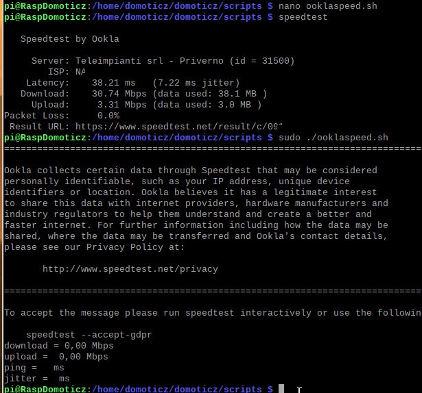

Sorry about the ooklaspeed.shFireWizard wrote: Monday 06 December 2021 18:38Hello @SavioThecnic
From time to time Ookla Speedtest requires that you accept their license.
You will not see this, until you open a terminal and activate the speedtest-cli manually..
However it is indicated in Domoticz with a red bar above your widget, that it has exceed the maximum time for that sensor.
In the first version of the script, the first part of the command was as follows:
Currently I use:Code: Select all
/usr/bin/speedtest --format=json
This works fine for me, so far.Code: Select all
/usr/bin/speedtest --accept-gdpr --format=json
But you may want to add --accept-licence as well. See the @grutter post.
You can test from the command line in a terminal.Regards

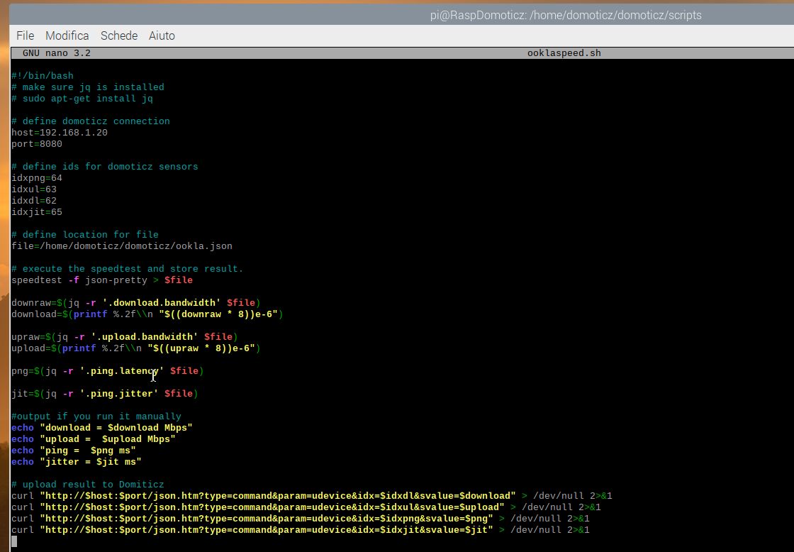

I do not find the item you mention I am attaching my ooklaspeed.sh
that I did by seeing your example
Where should I add the entry to accept the license
In fact, via script it does not work by launching it manually it works As you can see from the attached screenshots
Hope by fixing your script or with the red knot
with one two two systems can solve
my ooklaspeed.sh

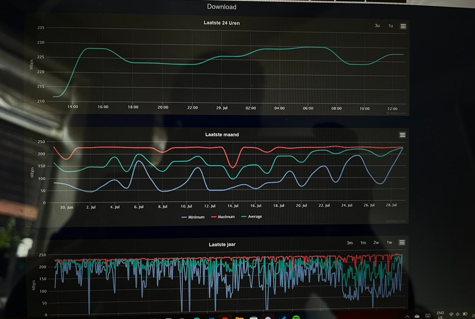

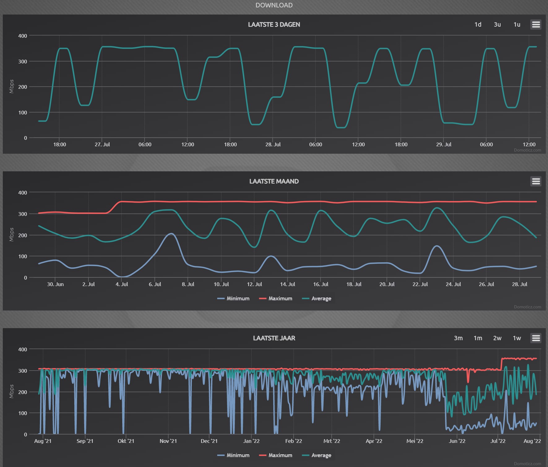

Does anyone know if there has been a change at Ookla for cutting down the times you can do the test? Because around the 20th of May I have a bigger difference between download values:
I asked someone who also use the CLI script in Domoticz and it seems he also experiencing the same, although his difference is not as big as mine:
PS: I also asked my internet provider the question if it might be an issue with my connection, this is still in investigation

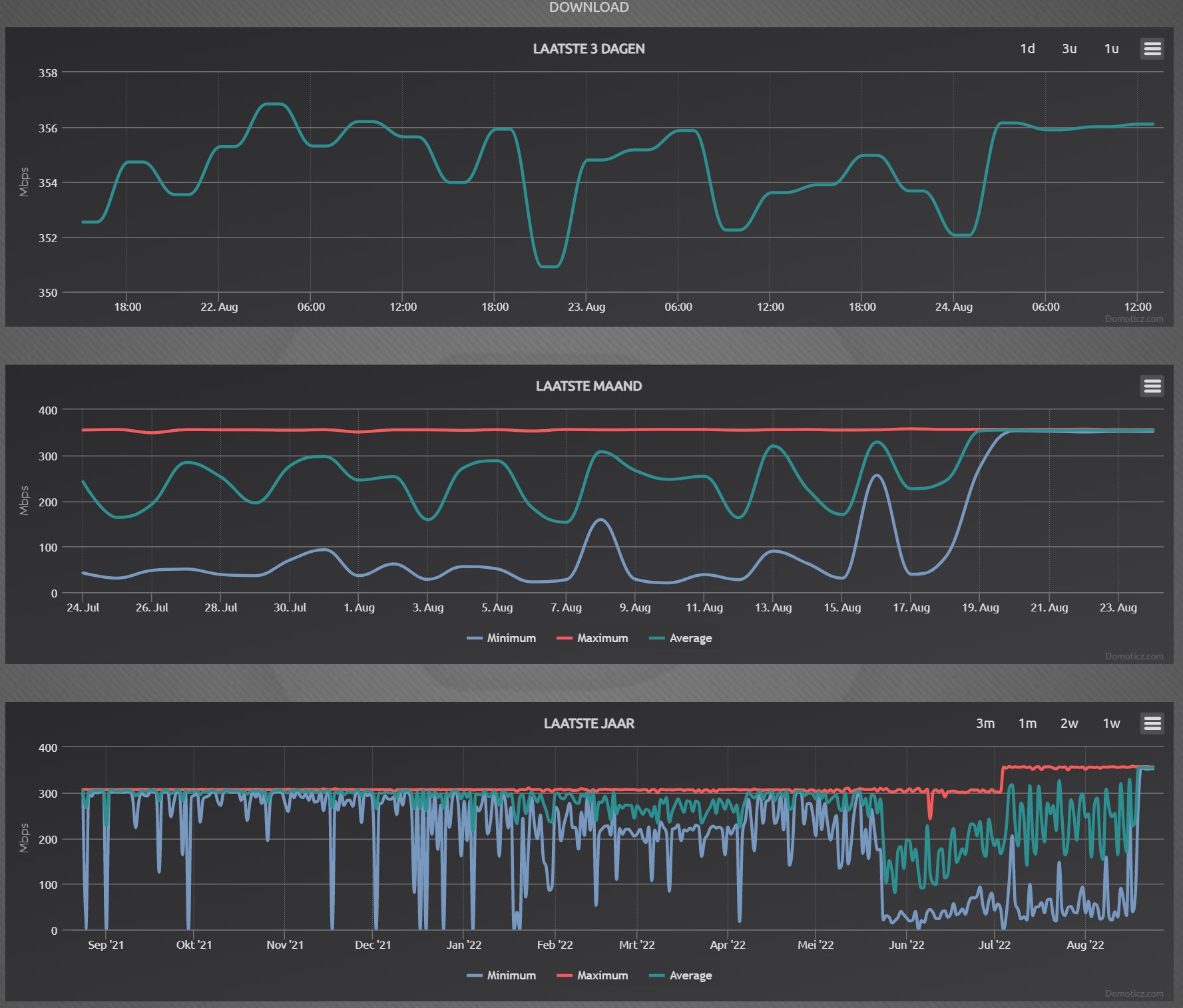

It seems that at Ookla there is a server that not responds correctly on the download. Because after editing the script with a specific serverjberinga wrote: Wednesday 03 August 2022 14:38 Does anyone know if there has been a change at Ookla for cutting down the times you can do the test? Because around the 20th of May I have a bigger difference between download values:
(# execute the speedtest and store result.
speedtest --server-id=13130 --accept-license --accept-gdpr -f json-pretty > $file)
it all looks much better
