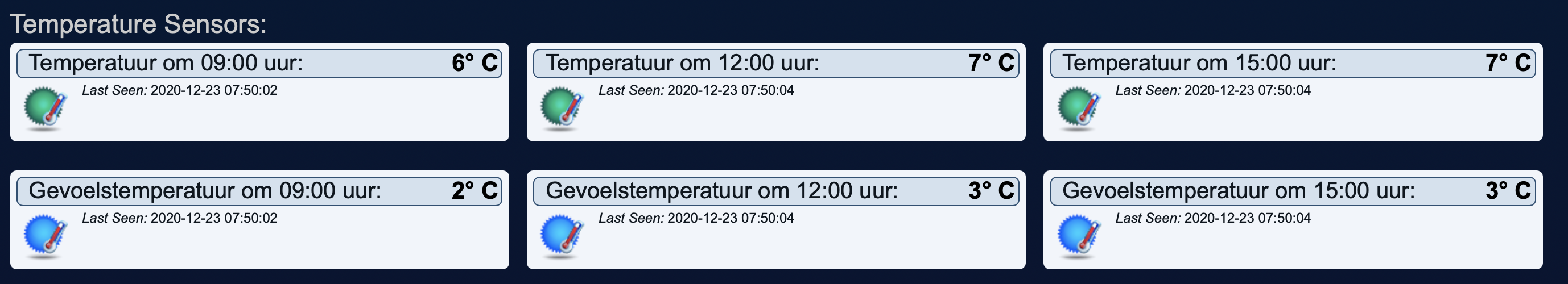

My script just used the sensors I needed at that time, but the new module got them all. Nice. I’ll see if I can make a script to clean it up a bit though. I don’t like ‘Hour 1’ or ‘Day 1’ and in my script I change the device names to like “Precipitation at 16:00h” or “Feel temp tomorrow (Thursday)”.

Sorry, I somehow missed the question... So with a bit of a delay: yes, the script changes the names of the virtual devices every hour.
Something like this:
		forecast_temp_6h_deviceName 	= 'Temperatuur om ' .. os.date("%H", OWMMain.hourly[6].dt) .. ':' .. os.date("%M", OWMMain.hourly[6].dt) .. ' uur:'
		newName 			= domoticz.utils.urlEncode(forecast_temp_6h_deviceName)
		url				= domoticz.settings.url .. "/json.htm?type=command&param=renamedevice&idx=" .. idx_forecast_temp_6h .. "&name="  .. newName
		domoticz.openURL(url)
