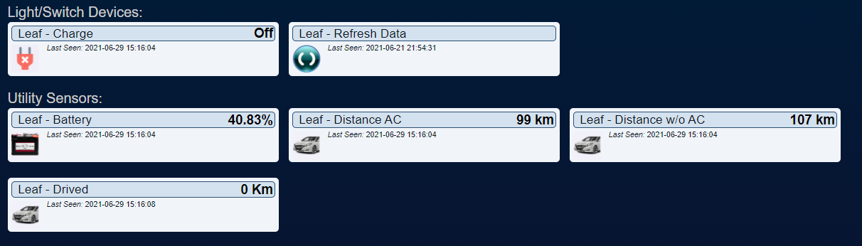

Sorry, the readme is only in french today but once you will have installed the plugin 6 devices will appear:
  • Battery Level (%)
  • Range without AC (km)
  • Range with AC (km)
  • Distance drove ( :!: divider has to be managed manually)
  • Car state (plugged or not)
  • Swtich to refresh data manually
