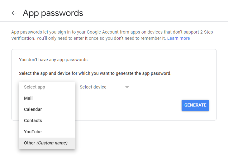

Indeed using a google app password
The less secure apps option is unavailable for use if 2-Step verification is enabled on your G Suite or Gmail account. You will have to get an app-specific password for Domoticzfor the SMTP to work. To do so, please follow the steps below:
Go to https://security.google.com/settings/se ... ppasswords and sign in to your account.
Select Mail from the list of apps available.
Select Other from the device list.
Enter your Custom Name. You can put “Domoticz” in it.
Click the Generate button.
Copy and save the password in the Domoticz password for email field.
Click the Done button, and that’s it.

Posts: 6677
Domoticz version: 2025.1
Re: GMAIL: No more login/passwd soon...
You have to switch on 2-Step verification first (!).
Then you can add App paswords in the same screen.
Use other, type 'Domoticz' and click on Generate
Use the 16-character password as password in Domoticz email setup.
