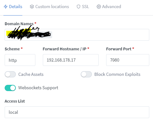

I wish I could help you, but I use the Nginx reverse proxymanager webinterface and I just turned websockets on in the settings menu:
- websockets.PNG (16.87 KiB) Viewed 2469 times
