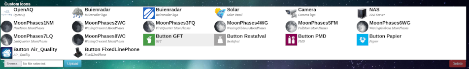

Upload the ZIP file. If you are successful, you will see something as below:
Screenshot_custom icons1.png (90.52 KiB) Viewed 999 times

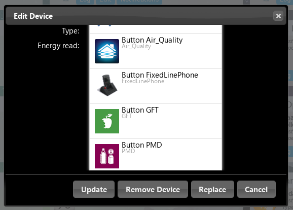

If everything has been done correctly, you will see your icon and if it is possible you will find it also in the row of selectable icons.
Screenshot_custom icons2.png (38.57 KiB) Viewed 999 times

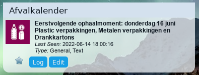

Imagine that you want to use the Purple button (PMD), you have to give the following command:
url//json.htm?type=setused&used=true&name=Afvalkalender&idx=497&switchtype=0&customimage=118
This will give you the following (in this case a text sensor) widget.
Screenshot_custom icons3.png (51.94 KiB) Viewed 999 times
