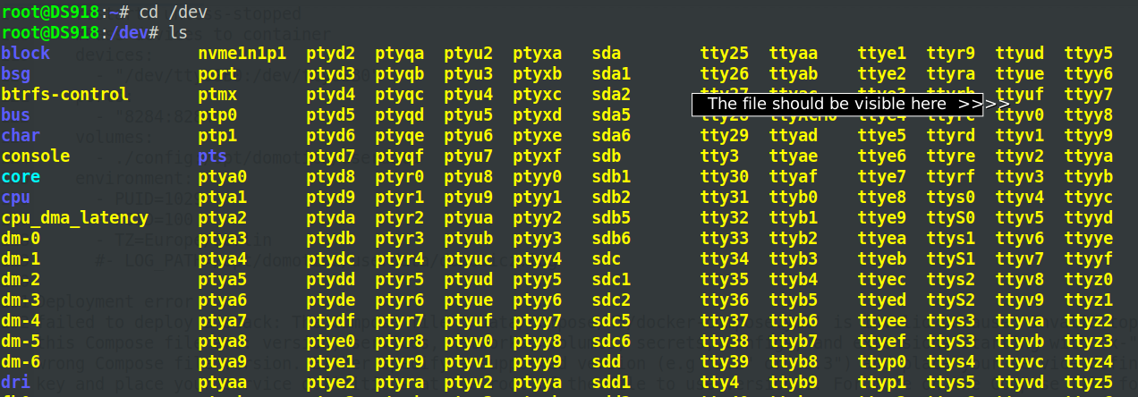

achim
- Posts: 4
- Joined: Friday 27 May 2022 5:37
Re: Synology - guide to switch from Jadahl package to official docker (domoticz-docker)
Thank you for the quick help. But somehow I still don't understand it all. There are no files behind the link from @pyxis (DSM_7) and the drivers from @JackD are already installed for me. What I'm missing is the ttyUSB0 file in the /dev directory - but it has to be there if docker-compose is started via Portainer.
Note:
Isn't it possible for someone from Synology DS918 users to send me the "ttyUSB0" file as an attachment?
Look here:
Note:
Look here:
- screenshot_73.png (194.63 KiB) Viewed 2262 times

achim
- Posts: 4
With this note you have given me a very valuable tip, namely I use an external USB hub. Meanwhile, I also found an update from Deconz-Docker:JackD wrote: Saturday 28 May 2022 13:02
Do you use a external USB hub perhaps, some of them do not work with Synology ....
https://github.com/deconz-community/deconz-docker
There you will find the note that instead of "ttyUSB0" you can alternatively use "ttyACM0". This file is in my "/dev" directory and it solved my problem.
Thanks again for your support!

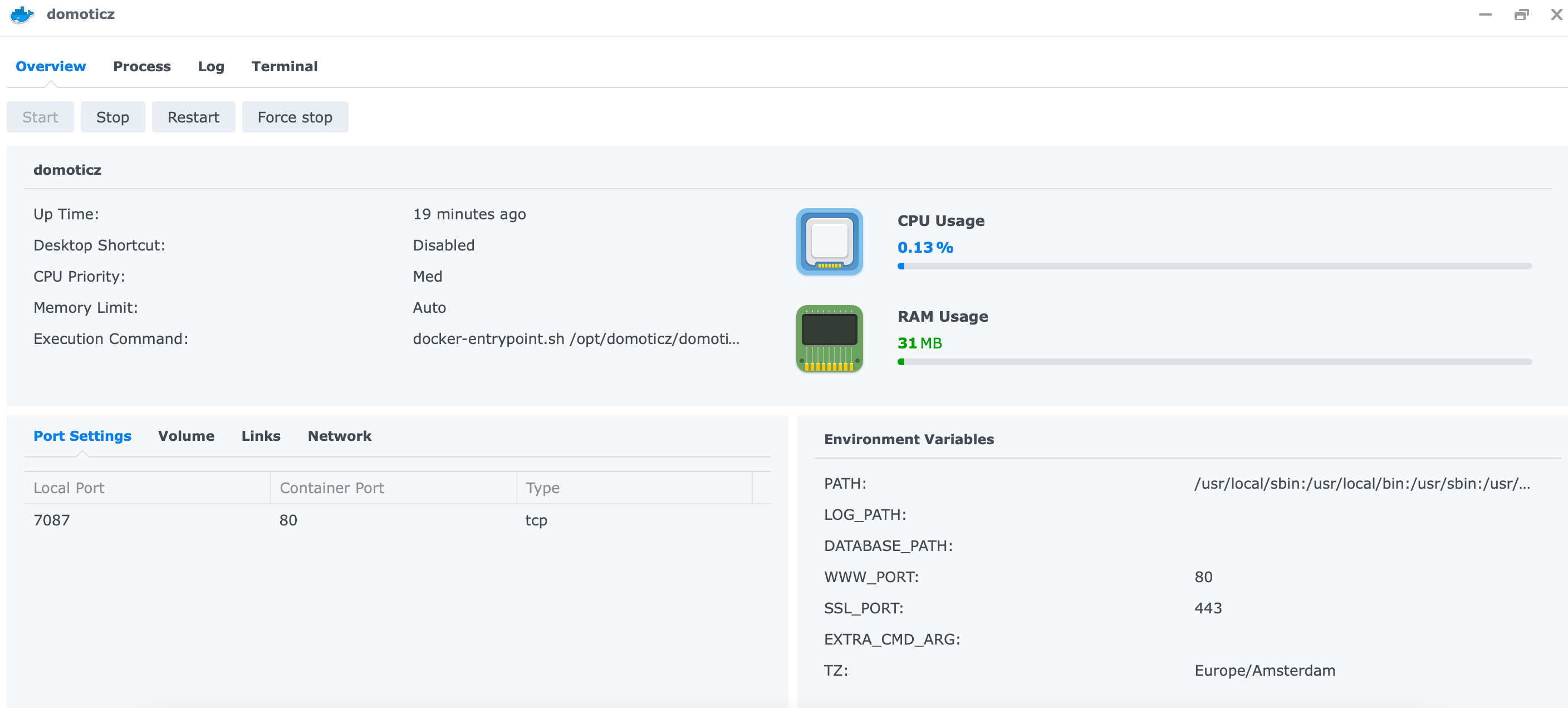

Hi, I'm on DSM7 and ran into some problems I'd like to fix.
Is there a step-by-step tutorial already for DSM7 in which is explained how to change the settings (like paths) so that it runs smoothly without "save errors" etc. ? Or is the opening message still the way to go?
My Domoticz is running, but I have the errors when saving a dzVents/Lua script. I added some folders manually:
volume1/docker/domoticz/backups
volume1/docker/domoticz/scripts
volume1/docker/domoticz/scripts/dzvents
volume1/docker/domoticz/scripts/logrotate
volume1/docker/domoticz/scripts/templates (this directory has to include the templates from container /opt/domoticz/scripts/templates)
volume1/docker/domoticz/scripts/dzvents/data
volume1/docker/domoticz/scripts/dzvents/dumps
volume1/docker/domoticz/scripts/dzvents/generated_scripts
volume1/docker/domoticz/scripts/dzvents/scripts
but don't know how to proceed from here.
As you can see, the settings/paths are not the way they should be, although it works for now.
- Schermafbeelding 2022-08-10 om 13.09.48.png (236.81 KiB) Viewed 1963 times
- Posts: 6677
- Domoticz version: 2025.1
Check the screenshots in this post of user Gravityz posted earlier in this thread : viewtopic.php?p=279443#p279443
See the paths in the Tab Volumes
- mvveelen
- Posts: 710
- Joined: Friday 31 October 2014 10:22
- Location: Hoorn, The Netherlands
Thanks, I've seen this, but don't know how to change the current setup. That's why I was wondering if there is a how-to for DSM7 with the most recent variables/paths. It's for a setup at my father-in-law's Synology and I don't want to break the current setup.waltervl wrote: Wednesday 10 August 2022 15:12 Check the screenshots in this post of user Gravityz posted earlier in this thread : viewtopic.php?p=279443#p279443
