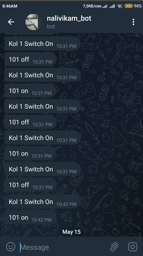

Now when I put a motion sensor that is numbered "101" and it starts sending a notification it should come "101 on" and "101 off". he is on GPIO4.
now from this sensor I see a notification from a sensor that is on GPIO14. I would like it to come only from GPIO4 named 101.
I'm uploading a picture
Help me please!

I do not understand your question about notifications on the switches.
Are the 2 switches in Domoticz being updated by the ESP8266 correctly now?
How do you send those notifications? It is not related to the ESP8266 device program but is normally managed by Domoticz Notification system or some Domoticz scripts.
Edit: Seems to be this topic: https://domoticz.com/forum/viewtopic.php?f=59&t=38446 for the notifications. Better have the discussion about notifications there.
