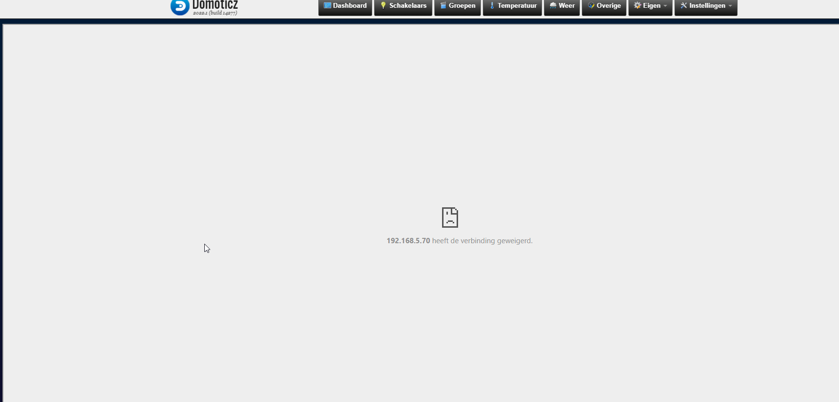

Only i try als get grafana working with an i frame with:
<IFRAME SRC="http://192.168.5.70:3000/d/T5Z_WDkRz/domoticz?orgId=1&refresh=1m" height="800" width="100%"></IFRAME>
Only i get an error:
Do you know how to fix this
Posts: 6689
Domoticz version: 2025.1
Re: Zigate/zigbeefordomoticz user interface within Domoticz UI
Some applications refuse to be shown in an Iframe. For grafana you could check out this thread https://community.grafana.com/t/dashboa ... ndow/19304
