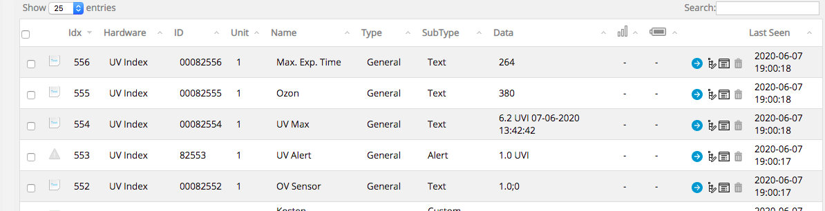

So... It seems I now have this working. Removed MQTT and node-red completely and reinstalled, now it works as it shoudl.
Just not sure if I have the sensors right.
- EdwinK
- Posts: 1820
- Domoticz version: BETA
- Location: Rhoon
Re: OpenUV.io plugin max. 50 request/day
Chanced IDX 552 to an UV sensor

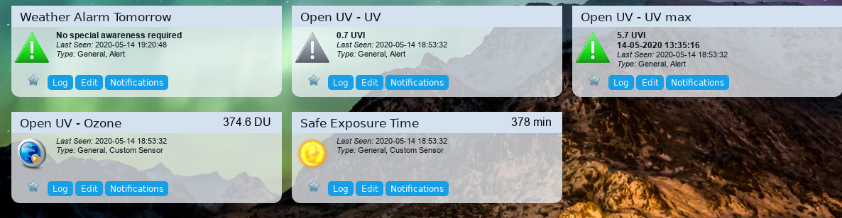

The sensors you want to use, is in fact up to you. E.g a "Text" sensor can contain more text than a "Custom Sensor".
I have the following:
For the "Open UV"sensor, called UV index, I use a UV sensor. This one will appear under the "Weather" tab.
For UV and UV max, I use for both an "Alert" sensor. They will appear under the "Utility" tab.
My function node (see below) is based on the use of an "Alert" sensor.
For the "Safe Exposure Time" and the Ozone sensors, I use "Custom" sensors.
On the x-axis of "Safe Exposure Time" you should use min. On the x-axis of "Ozone" you should use DU, which stands for "Dobson Units"
If you want, you can change the icon for a "Custom" sensor, which you cannot for a "Text" sensor.

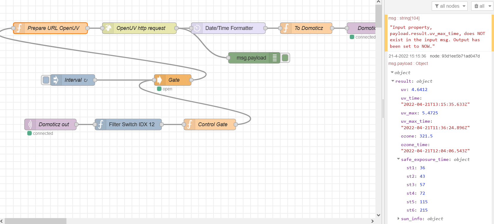

The sun is shining more and more intensely so I regularly look at my UV sensors again. I use the flow below (thanks @FireWizard). Unfortunately, the flow gives an error message (see sidebar). I can't explain the error and therefore can't fix it. The settings of the moment node can also be found below. Does anyone have an idea how to fix this?
Thanks in advance.

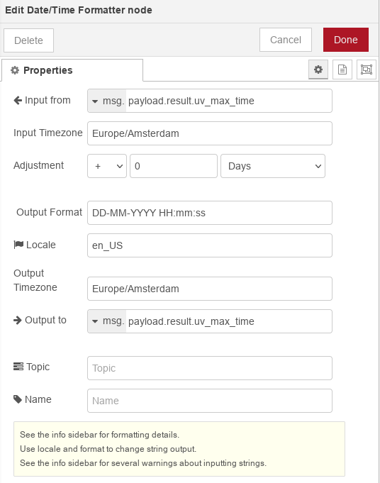

This error message comes from the "moment" node, called Date/Time Formatter.
As you can see in the Debug output below msg.payload.result.uv_max_time exist.
However I see that your moment node shows a different "Edit" window. Might it, that you use an older version?
Mine looks like:
I do not use that node, but you might also try to put as "Input msg msg.payload.result.uv_max_time instead of only payload.result.uv_max_time.
If it works do the same with the Output msg.
Let me know.

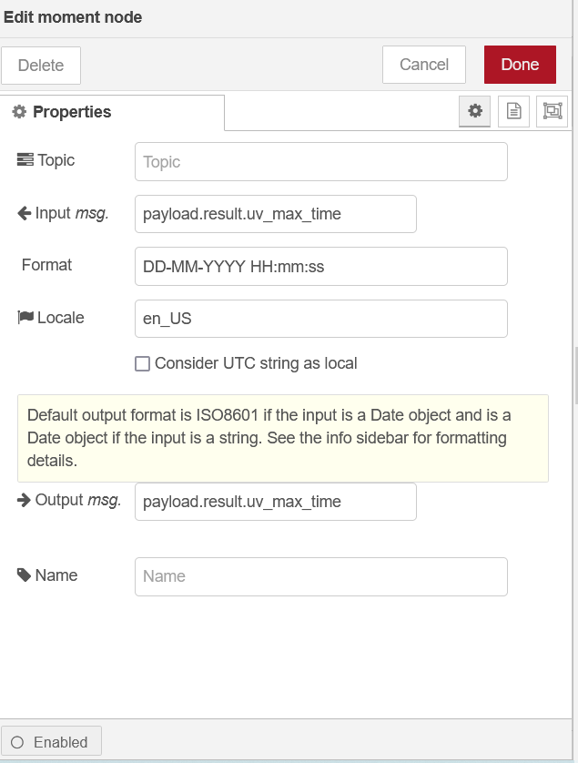

My system is up to date. I can't explain why my moment node looks different.FireWizard wrote: Thursday 21 April 2022 16:34
Changing the input and output msg has no effect. Which node do you use instead of the moment node?

I use: node-red-contrib-moment and then specific the moment node.
See: https://flows.nodered.org/node/node-red-contrib-moment
It is called "Date/Time Formatter".
This works fine for me.

Thanks, it works again! I used node-red-contribute-moment2. With that, the flow has worked well before. The icon of the moment node is exactly the same as the icon of the moment node of node-red-contribute-moment. Under the hood there are differences.
