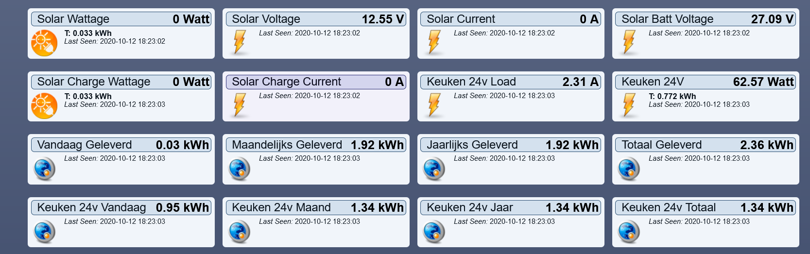

epever.tracert.to.domoticz.sh
Tested on : EpEver Tracer 3210AN 30A MPPT Solar Controller
Date : 12-10-2020
Version : 00,00.00,000.2
Requirements : apt install bc sed
Created by ILoveIOT 2020
Updated by ILoveIOT & Micha123 2022
- Added battery temp
- Added SOC value
- Correcting the actual voltage on the battery side
- Changed some small things in this script
- Added Real Battery Curent (Charging and Discharging) it wile be calculated from PVPOWER - LOADPOWER
- Fixed Batterycharging Power, now its calculating PVARRAYPOWER - LOADPOWER (bevore it shows the same as PVARRAYPOWER)
- Add a check if Values in $OUTPUTFILE are present, if there are no values then ihe script wil stop and dont send ZERO value to domoticz
This script will execute the /root/scripts/epevertracer/epever.tracer.php file put the output to a file,
get the value's from the output file, show them on console if needed, and send them to Domoticz, this is super simple, easy to change.
Many thanks to Toggio https://github.com/toggio/PhpEpsolarTracer
For console use : /root/scripts/epevertracer/epever.tracert.to.domoticz.sh
For crontab use : /root/scripts/epevertracer/epever.tracert.to.domoticz.sh >> /dev/null 2>&1
For all the info : php /root/scripts/epevertracer/example_cli.php
1. Change the serial port /root/scripts/epevertracer/epever.tracer.php line 26 ('/dev/ttyUSB1')
2. Change the Domoticz IP & Port (see below)
3. Add/Change the acording Domoticz IDX's (see below)
4. Optional : Change the working directory, where you wanna place the files
5. Optional : If you need more info from the controller compare epever.tracer.php vs example_cli.php
6. Optional : Maybe make 2 cronjobs, with no sunhours just poll once a hour, with sun every min.
Just make a normal network cable for this controller, I believe blue and green between a ch940 rs485 to usb converter or buy the 10$ org cable, org cable had problems on linux, buy cheap ones, ch940, and maybe with ground, me in testing mode.
EpEver Solar Controller into Domoticz
- ILoveIOT
- Posts: 59
- Joined: Sunday 25 March 2018 17:47
- Domoticz version: 2020.2

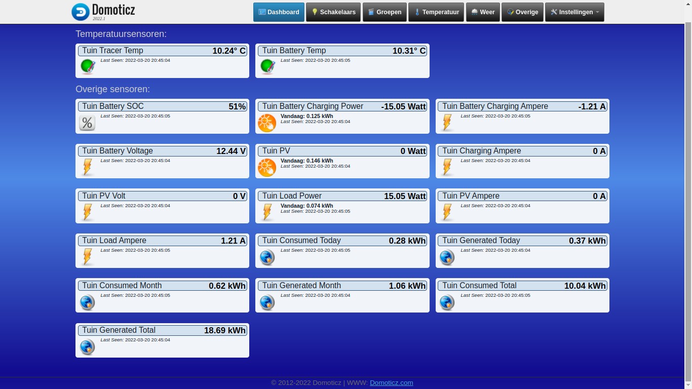

Micha123
- Posts: 62
- Joined: Monday 28 August 2017 16:44
Re: EpEver Solar Controller into Domoticz
nice, its working
i have modified the script a little bit.
i have added the Battery SOC (state of charge) and also the battery Temp (i have an external sensor for the battery connected to the epever solar charger
i has also sometimes an problem that the comunication to inverter goes wrong, and the script send then only ZERO values to domoticz (now its fixed)
also add the modified file for every one
- Disabled Year Generated (the same reading as month) it can be enabled by removing the #
- Disabled Year Consumed(the same reading as month) it can be enabled by removing the #
- Added Battery Temp (i have an external BATT sensor connected to the tracer)
- Added battery SOC (State of Charge in %)
if you wil use my modificated script then you need to install bc, bc is needed for the calculations in the script
sudo apt install bc
HAVE FUN
sudo apt install bc
HAVE FUN
- Screenshot_20220320_165335.jpg (202.26 KiB) Viewed 3810 times
- epever.tracert.to.domoticz.zip
- (2.35 KiB) Downloaded 111 times
