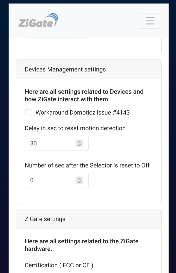

Second, there is a setting in the plugin User interface on port 9440 that configures the motion device auto switch off time (default 30 sec).

I have the following "Delay in sec to reset motion detection" setting in menu settings:

Thanks a lot! I found it and this really worked for 60 sec. But now there's left only one problem. ZiGate doesn't allow me to reset the PIR's internal counter. So if there is a movement within those 60 sec, the sensor switches still off after the 60 sec periond for another 60 sec delay and there will be a darkness. Z2M allowed, as it is previwed, to make a movement and move forward this 60 sec delay time, until the person has left the toilet.
