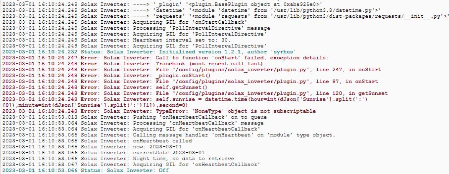

I have just updated to the latest version of Domoticz 2023.1 on Docker and getting the following error on the Solax Inverter
When using:
http://Domoticz-IP:Port/json.htm?type=command&param=getSunRiseSet
The result is:
"AstrTwilightEnd" : "19:09",
"AstrTwilightStart" : "04:33",
"CivTwilightEnd" : "17:52",
"CivTwilightStart" : "05:51",
"DayLength" : "10:54",
"NautTwilightEnd" : "18:30",
"NautTwilightStart" : "05:12",
"ServerTime" : "2023-03-01 16:18:33",
"SunAtSouth" : "11:51",
"Sunrise" : "06:24",
"Sunset" : "17:18",
"status" : "OK",
"title" : "getSunRiseSet"

Hi Biarritz (French guy? ;) )
Could you please try to install the latest version 1.2.2?
Let me know if you still have the issue.
