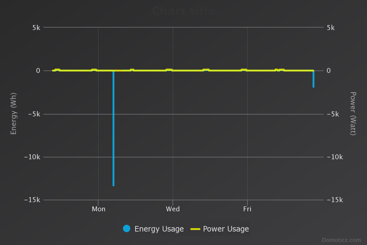

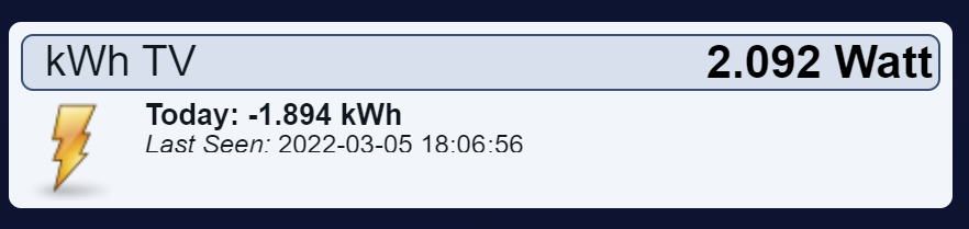

There is a bug in the total energy consumption after a power outage that has been there forever with the AEON ZW075.
Since it seems that it reset its total consumption after a power outage and sends out 0kWh, the calculation in Domoticz is totally screwed up. I my case I hade a power outage on Monday and then today Saturday and the scale is way off for the power consumption. Instead of 0-150W what I normally measure, the scale goes from -15000W to 5000W,
What makes things even worse is that I cannot remove the faulty measurement on the short term scale, only the long term scale, so in my case the reading is somewhat difficult for a week
It should be reasonably easy to correct these behaviors even though it seems that it is only (?) the AEON ZW075 reports energy consumption differently.
