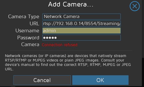

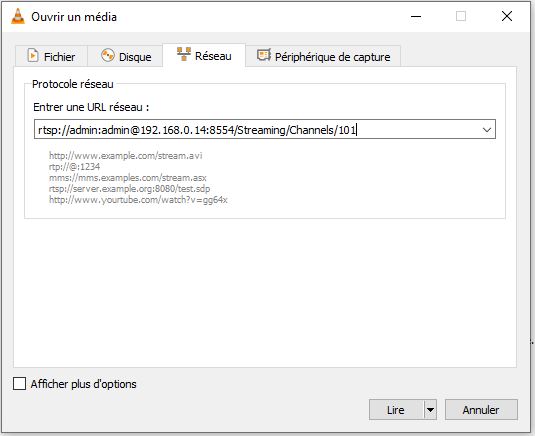

Hello !
I try to connect my doorbell to motioneye with those settings but impossible to do this.
Even in vlc impossible to display someting.
PLease, could you explain how to do ?
Thanks in advance.
Best Regards
Jean
hoeby
Posts: 531
Joined: Saturday 02 June 2018 11:05
Domoticz version: V2022.1
Location: Echt, Netherlands
Re: Doorbell from Action (LSC Smart Connect)
Post by hoeby »
In motioneye you have a wrong ip/port written. Don't know if that is the problem, but try it
You have: 192.169.0.14/8554
This must be: 192.168.0.14:8554
Also try in motion eye to keep the username and password empty. And place those in the url, like eddy posted.
I have a foscam doorbell. That only works with user/password in the url, not by adding them in there own fields

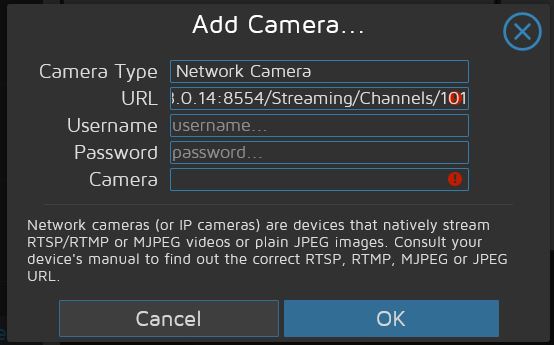

fx4sky
Joined: Tuesday 16 November 2021 21:23
Post by fx4sky »
EddyG wrote: Sunday 11 July 2021 15:37 Got the RTSP stream
rtsp://admin:[email protected]:8554/Streaming/Channels/101
rtsp://admin:[email protected]:8554/Streaming/Channels/102
First one is 1920 x 1080 and the second one is 640 x 360
The last one is suitable for display in Domoticz
Searching further....
Thanks for your answer.
I tried with your two solution and that is the results :
I don't know if your are using the smart connect LSC smart doorbell 1080HD with Module MCU V2.10.5 ?
thanks for you help again
Best regards
Jean
EddyG
Posts: 1042
Post by EddyG »
In the first post I state which version I am using. It seems one of the latest version which is not susceptible for the hacks found on the Internet.
These are the streams that I found with this version.
