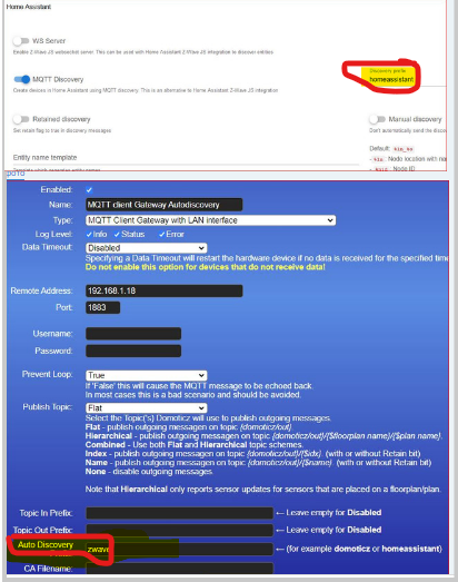

Ok, So the first screencapture shows the MQTT Topic prefix : homeassistant -> This is the MQTT topic used for the AD CONFIG package which ALSO need to be defined exactly the same in the DOMOTICZ MQTT Hardware definition in field "Auto Discovery Prefix"!
You have there the zwave prefix, which is used for the state update mqtt message from ZWAVEJS2MQTT.
SO simply make this one change and you will be in business! :)
