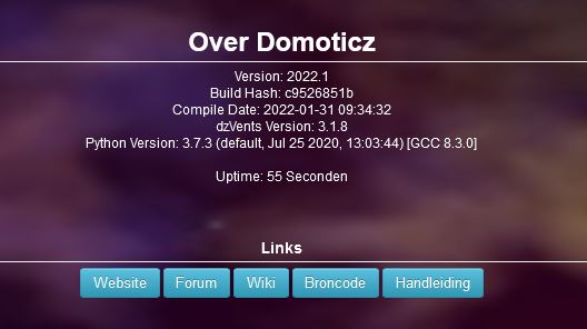

I am currently on the latest version 2022.1
I tried the following:
Deactivate the Slaapkamer hardware
Activate the Woonkamer hardware
Reboot
Activate the Slaapkamer hardware
Then all works fine and no problems at all.
Does not matter which of the two I do deactivate.
I agree with you that the problem could be caused by a Domoticz update. The plugin startup process is problably changed as I read in your messages.
I have ordered a new sd card to test with an older domoticz version of my backups in a couple of days as i do not want to overwrite my production sd card.
kollemt
Posts: 29
Joined: Monday 18 February 2019 20:41
Domoticz version: 2020.1
Re: Python Plugin : Broadlink
Post by kollemt »

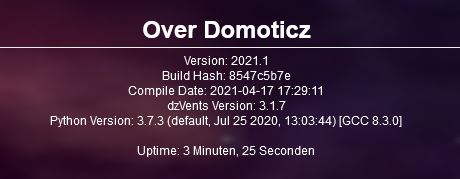

I installed Domoticz version 2021.1. No problems.
When back to my production Domoticz version 2022.1. Again the same problems.
Looks indeed that the problem was introduced with a later Domoticz version:
2020.2 build 2021-03-11 OK
2021.1 build 2021-04-17 OK
2021.1 build 2021-12-23 NOT OK
2022.1 build 2022-01-31 NOT OK

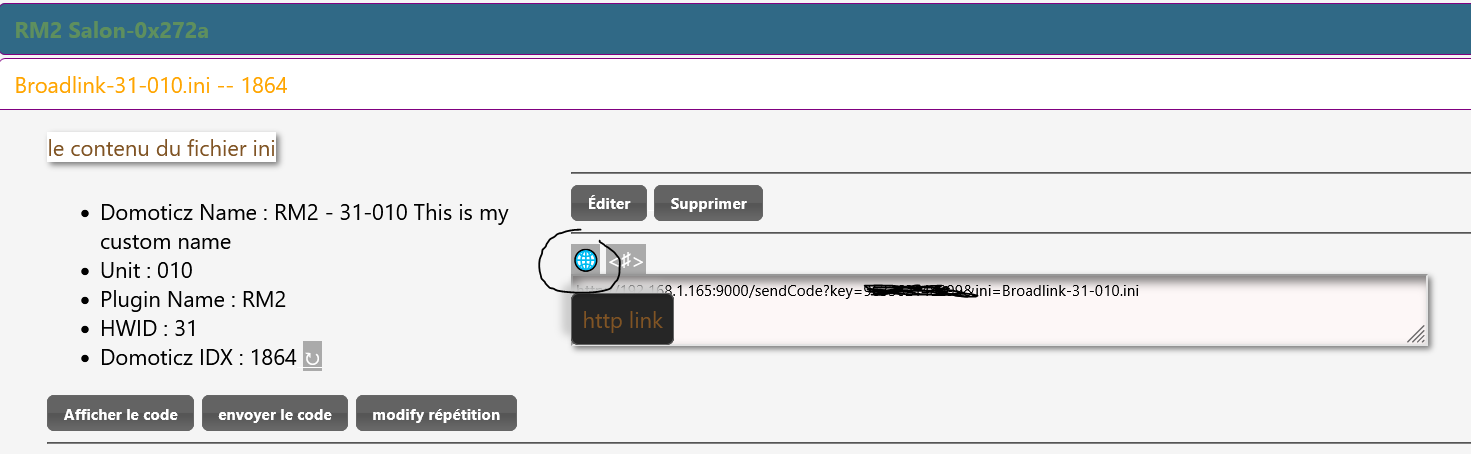

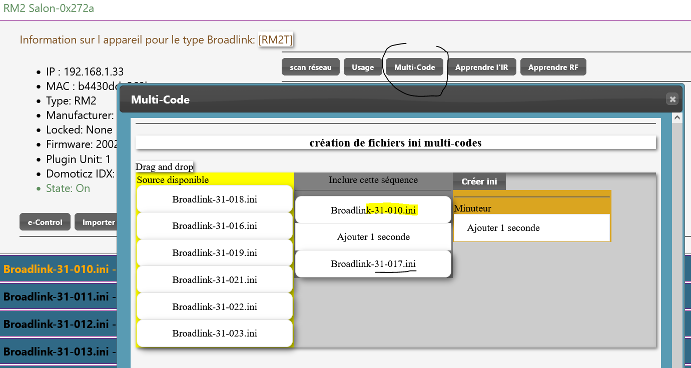

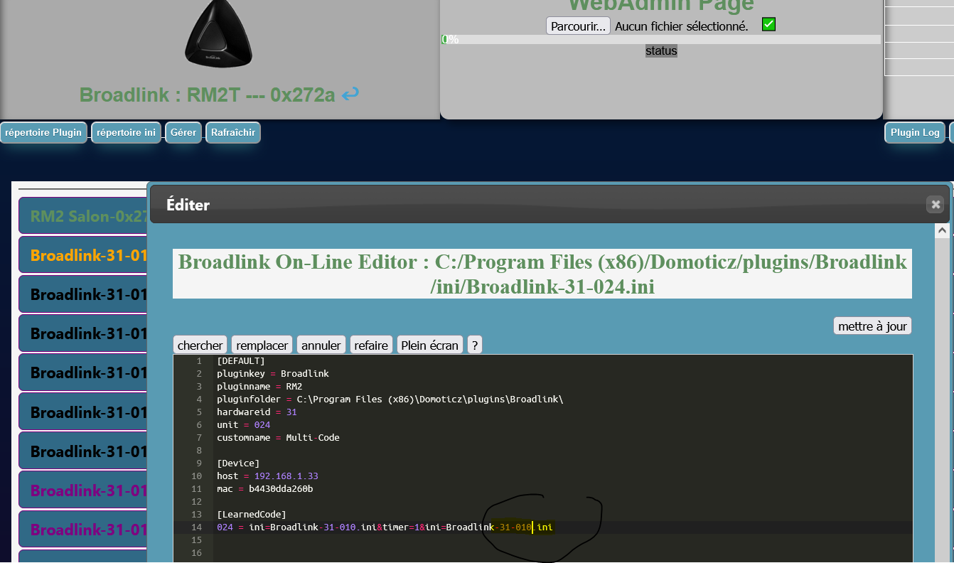

Click on the earth icon to have the http link :
Create a multi code ini file by selecting your desired ini number, add 1 second timer, add any other ini number :
edit the multi code ini just created and replace with your desired ini number:
