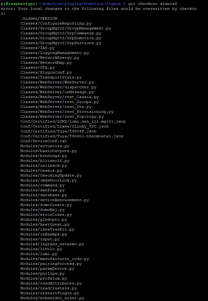

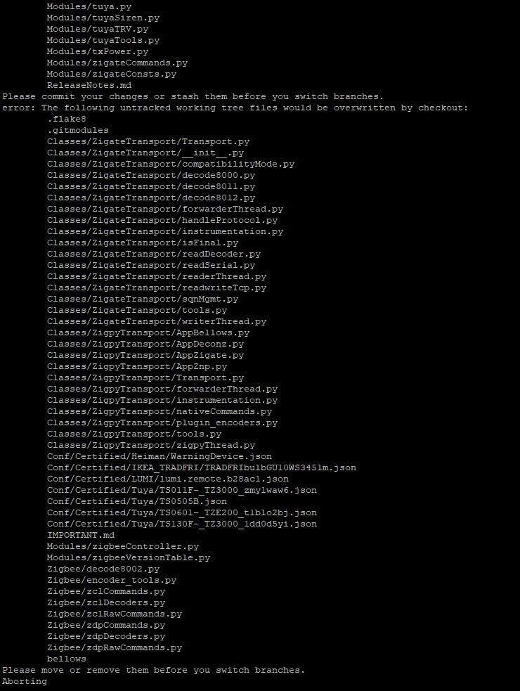

Yes thank you. I followed the command set to the letter but when I enter the checkout command in step 4 I get errors.
Your local changes to the following files would be overwritten by the command:
< a big list of files>
I got it working by adding the --merge command, but I think it messed up the ability to update in the future.
Going back to stable5 broke things
I am reverting to my backup.. (glad I followed the advice to make a backup .img of my system)

this is the error I get.
pipiche
Posts: 2016
Location: France
Re: Zigate and Aqara wall switch
Post by pipiche »
This sound like the repo is messed up
I would suggest to do the following - taking in consideration that you have a backup -
1/ stop the plugin (or domoticz)
2/ move the Domoticz-Zigate folder to a backup directory (outside of domoticz)
cd domoticz/plugins
mv Domoticz-Zigate /home/pi
3/ clone the repository
cd domoticz/plugins
git clone https://github.com/zigbeefordomoticz/Domoticz-Zigbee.git Domoticz-Zigate
4/ You'll be placed on stable6 after the clone, if you want to move to beta6
git checkout beta6
5/retreive the plugin Databases
cd domoticz/plugins/Domoticz-Zigate
cp /home/pi/Domoticz-Zigate/Data/*  Data/
cp /home/pi/Reports/* Reports/
cp /home/pi/Conf/PluginConf-* Conf
6/ you can restart the plugin
For reference:
https://zigbeefordomoticz.github.io/wik ... ackup.html
sudo cp /home/pi/Domoticz-Zigate/Data/*  Data/
sudo cp /home/pi/Domoticz-Zigate/Reports/* Reports/
sudo cp /home/pi/Domoticz-Zigate/Conf/PluginConf-* Conf
After those steps I continued the manual at step 5 and all worked out well. Still have all previously coupled devices in domoticz.
