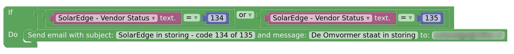

I had a (second) look at blockly to see if I could find the device and set it up to send an email if the error code occurs. Not sure if it works though since the error has not occurred again :)
This is what I came up with
Let's hope I never need it :mrgreen:

Sjonnie, what is the normal status ?
Mine is moving from MQTT ,starting , shutting down.
Pick a status which has a daily change and you can check if your script is working.....

If the error is "resolved" (meaning the Solaredge is back in business) the reported status is "0". Good suggestion to check against this status! I will test this so I know the Blockly works.
