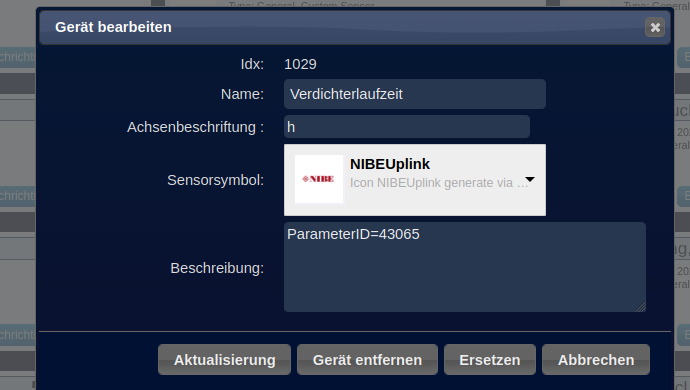

im a newbie in terms of dvents but i've already created some working srcipts for my energy counters. Now i need a small hint how to transfer data from "real devices" in domoticz into virtual devices in domoticz.
My idea is to modify/filter the data (due to negative values/bad counting) and send the corrected data to the virtual device
For this example i want to show the data of daily usage of my NIBE heatpump . The device 1029 was automatically created by the NIBE heatpump script, so that i cannot change the device anymore.
My script should check every hour the device 1029 and receive the value and transfer it into the new virtual device XXXX
But i have no idea how to do it. But it should be similar to my http request script, correct?
Bildschirmfoto vom 2022-02-06 10-14-22.png (38.43 KiB) Viewed 1077 times
Bildschirmfoto vom 2022-02-06 10-13-54.png (36.52 KiB) Viewed 1077 times

In DzVents you can get values directly from a sensor. No need for a http command.
Get the device type of the original device in menu setup devices , get the correct value function from the DzVents wiki, get the value and update the new sensor.
So for example for a custom sensor the get value command is
local oldvalue = domoticz.devices('mysensorname').sensorValue
