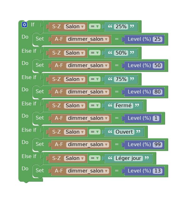

I created a script to automate the roller shutters of my house
    active = true,

I have a variable 'lastPosDimSal' which I use to store the value of the dimmer.
Two user variables 'var_tpsDec' and 'var_tpsDecDn' which I use to define the rise and fall times of the shutters a 'var_actPosDimSal' which contains the last value of the dimmer before the change of state.
This commands 2 ON/OFF type switches which control an esp-01.
I also put 1% and 99% corresponding to closed and open because otherwise the switches would not go OFF.
Then I created a selector with 6 buttons that allows me to select percentages of opening levels
controlled by a blocky script in 'trigger device' modifying the level of the dimmer. (closed, 25%, 50%, 75%, open, light daylight (13%).
It all worked perfectly. But since the last update the script is looping. It automatically resets the last position variable to 99 and never stops.
I admit that I don't understand where the problem comes from, knowing that this is my first attempt at a script.
Any idea that could enlighten me???
Thanks in advance.
