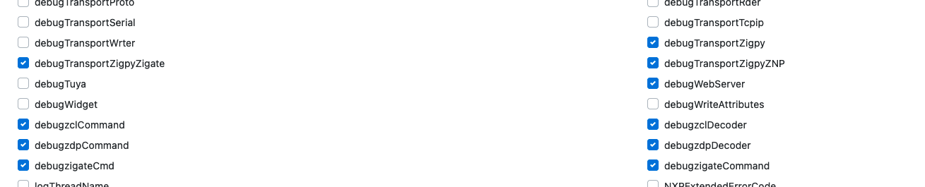

For instance, it wopuld be valuable if you can enable some debug parameter as shown on teh screenshot, start the plugin and then when getting the erreor sending the file Logs/PluginZigbee_xx.log (where xx is the domoticz Hardware Id)
