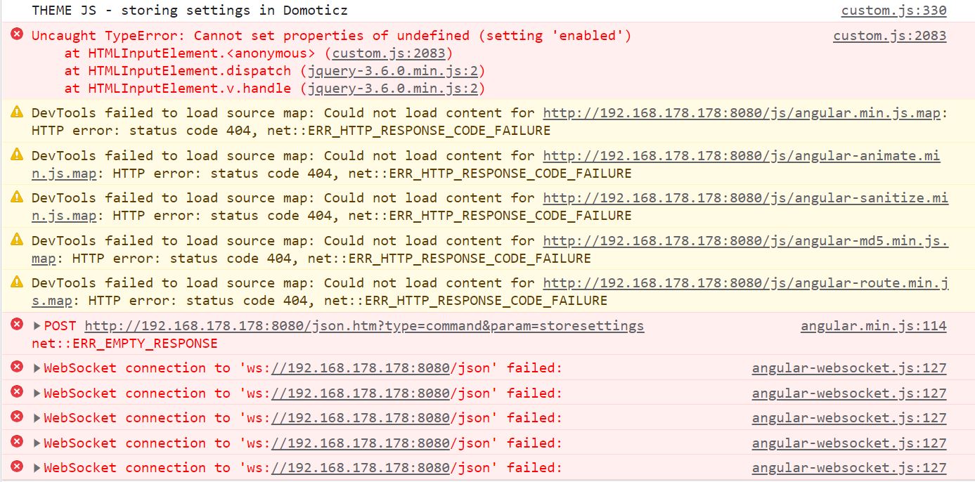

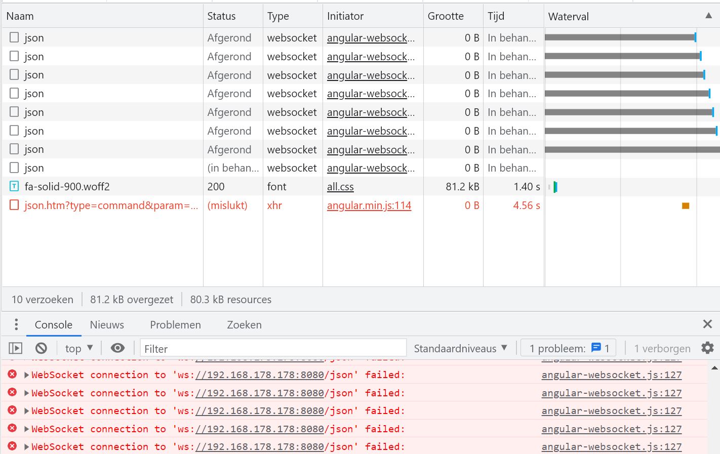

Check the 'Network' tab and then look for the line with the 'json.htm?type=command¶m=storesettings' (make sure you have 'preserve log' and 'disable cache' checked).
For this call, the 'Headers' and 'Response' data is probably the most interesting part.
Also, in the printscreen there is an error shown with the POST of the settings. Would be interesting to see what additional info it reveals.
Does the Domoticz back-end crash when saving settings? Do you need to restart Domoticz first before the UI works again?

Here's my log from the moment I hit the button "Save".
The Domoticz GUI crashes and with sudo service domoticz stop and start the system is working again, no changes are saved.

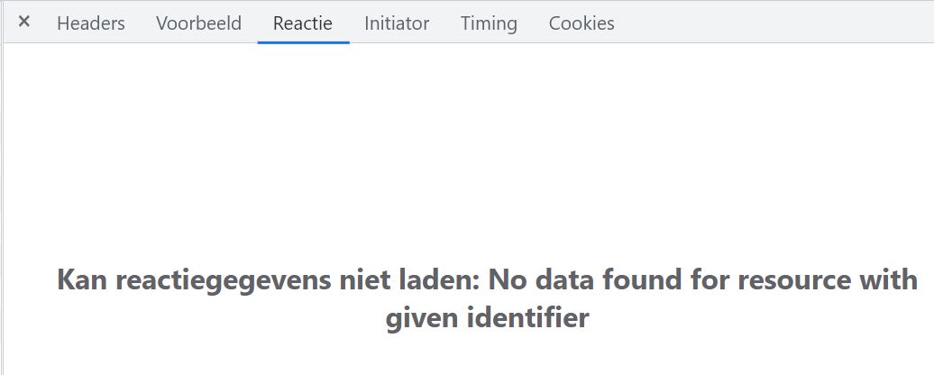

That is indeed the line. Please select it (the red one) and show the details, especially the Headers and Response (also Request data).

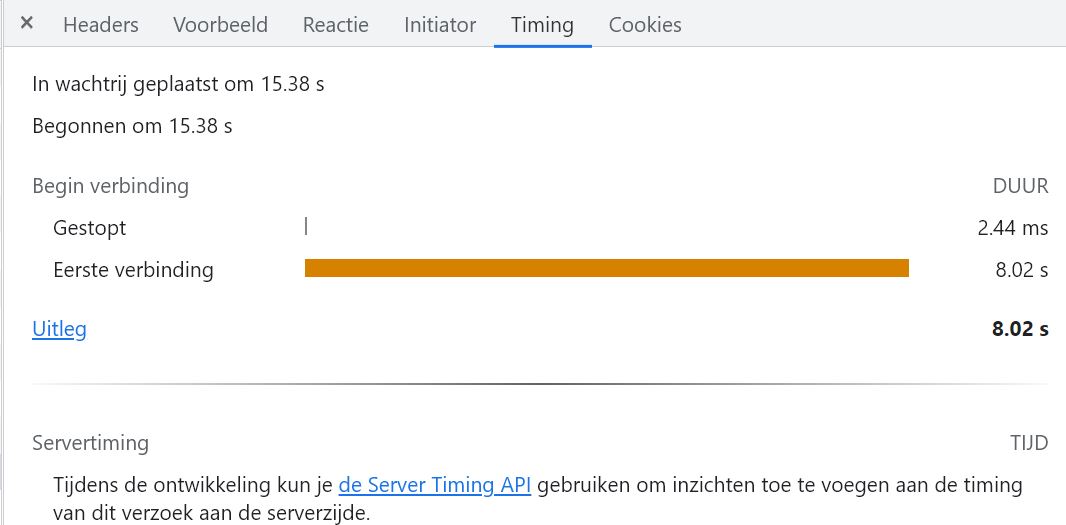

Timing
- Knipsel.JPG (52.81 KiB) Viewed 5484 times
