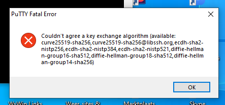

A small sidestep from Domoticz, but in line with previous question, related to runup to get a full installation.
Now for revival of a broken down Raspberry, decided to use the latest SD-card-imager.
Successful 'burning' of the OS-image, added an empty file called ssh to enable link with SSH-clients and a preconfigured file wpa_supplicant.conf to ease connection to the WLAN. Connection to WLAN went smooth.
All seems OK for further operation, and programs like WINSCP and Core FTP LE happily communicate with this 'new' RPI in SSH-mode,
but PuttySSH 'refuses' with complaint as shown in the attached picture.
;-( Another 'certificate-problem'?
Remedy or alternative available?
