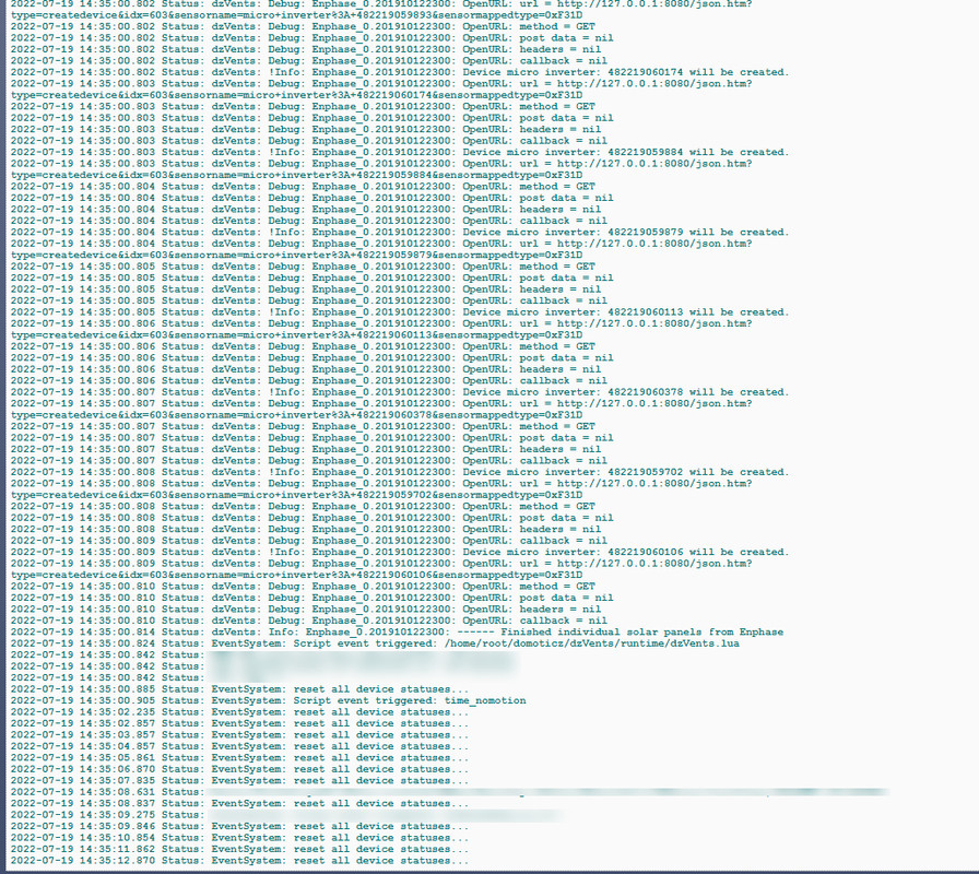

    If the createDevices switch is set to true. The script will create ALL the individual devices
    if they do not exist on the system yet. (1 total and 1 per panel (so if you own 20 panels it creates 21 devices)

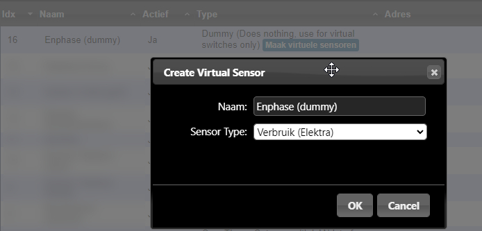

        Define a dummy hardware in domoticz if not already done
        Enter your settings at the appropriate place

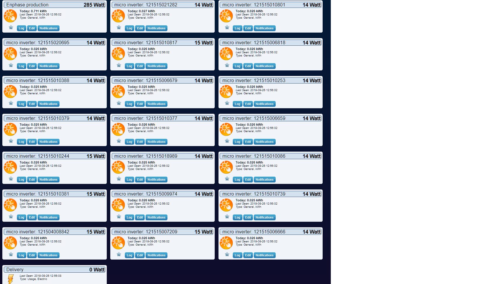

                        device.updateElectricity(newInverter['lastReportWatts'],device.WhTotal + tonumber(newInverter['lastReportWatts']) / ( 60 / frequency ) )
                        if device.switchTypeValue ~= 4 then changeInverter2DeliveryType(device) end
                        if dz.time.matchesRule('between 25 minutes after sunset and 23:59') then device.updateElectricity(0,device.WhTotal) end

                if not(dz.utils.deviceExists(deviceName)) and Enphase.createDevices then
                    dz.log('Device ' .. deviceName .. ' will be created. ', dz.LOG_FORCE)
                    createEnphaseDevice(Enphase.inverterDeviceType, deviceName)
                    updateInverter(dz.devices(deviceName), inverter, deviceName )

Updated version in first post:
It's a rainy day in the Netherlands....
Solar panels.png (162.75 KiB) Viewed 9442 times

Script fails when adding the virtual switches.
From the logging:
2022-04-04 11:40:00.423 Status: dzVents: Info: Enphase_0.201910122300: /usr/bin/wget -T 3 --user installer --password 1234567 -O - 192.168.178.171/api/v1/production
2022-04-04 11:40:00.455 Status: dzVents: !Info: Enphase_0.201910122300: Device Enphase production will be created.
2022-04-04 11:40:00.455 Status: dzVents: Debug: Enphase_0.201910122300: OpenURL: url = http://127.0.0.1:8080/json.htm?type=cre ... ype=0xF31D
2022-04-04 11:40:00.455 Status: dzVents: Debug: Enphase_0.201910122300: OpenURL: method = GET
2022-04-04 11:40:00.455 Status: dzVents: Debug: Enphase_0.201910122300: OpenURL: post data = nil
2022-04-04 11:40:00.456 Status: dzVents: Debug: Enphase_0.201910122300: OpenURL: headers = nil
2022-04-04 11:40:00.456 Status: dzVents: Debug: Enphase_0.201910122300: OpenURL: callback = nil
2022-04-04 11:40:00.456 Status: dzVents: Info: Enphase_0.201910122300: /usr/bin/wget -T 3 --user installer --password 1234567 -O - 192.168.178.171/api/v1/production/inverters
2022-04-04 11:40:00.524 Status: dzVents: !Info: Enphase_0.201910122300: Device micro inverter: 122206032705 will be created.
2022-04-04 11:40:00.524 Status: dzVents: Debug: Enphase_0.201910122300: OpenURL: url = http://127.0.0.1:8080/json.htm?type=cre ... ype=0xF31D
2022-04-04 11:40:00.524 Status: dzVents: Debug: Enphase_0.201910122300: OpenURL: method = GET
2022-04-04 11:40:00.524 Status: dzVents: Debug: Enphase_0.201910122300: OpenURL: post data = nil
2022-04-04 11:40:00.524 Status: dzVents: Debug: Enphase_0.201910122300: OpenURL: headers = nil
2022-04-04 11:40:00.524 Status: dzVents: Debug: Enphase_0.201910122300: OpenURL: callback = nil
2022-04-04 11:40:00.524 Status: dzVents: !Info: Enphase_0.201910122300: Device micro inverter: 122206034010 will be created.
2022-04-04 11:40:00.532 Status: EventSystem: Script event triggered: /home/pi/domoticz/dzVents/runtime/dzVents.lua
2022-04-04 11:40:00.563 Error: Error opening url: http://127.0.0.1:8080/json.htm?type=cre ... ype=0xF31D
2022-04-04 11:40:01.536 Error: Error opening url: http://127.0.0.1:8080/json.htm?type=cre ... ype=0xF31D
If I run"http://IP_DOMOTICZ:8080/json.htm?type=createdevice&idx=23&sensorname=Enphase+production&sensormappedtype=0xF31D"
I get "401 Unauthorized"
Idea could be to create the swicthes manualy, but waht type do I have to create?

I'm missing the information about what type of dummy hardware needs to be created?
When creating a new dzVents script, what type of script to create? (i assume All(recommended))
After i created a dummy sensor and filled in that IDx in the script it looks it started to work, the devices are created.
The only problem is that it is not reporting any production, and every "set frequency / 15min" there are created new devices again....this is clearly not right! What did i do wrong? There is a connection from the script to the envoy, otherwise it could not got the micro inverter serials...
SanderRoelofs
Posts: 17
Joined: Thursday 11 March 2021 10:03
Re: Get local Enphase data from individual solar panels in domoticz
Post by SanderRoelofs »
Only create a dummy hardware device not sensors.
Create just a normal dzvents scripts and make sure that settings are like below (offcourse use your own addresses)
local Enphase = {
ip = 'ip_address',
password = 'password',
dummyHardwareIDX = idx_number,
useProduction = true,
productionDeviceName = 'Enphase production',
useInverters = true,
inverterDevicePrefix = 'micro inverter: ',
createDevices = true,
Also make sure Domoticz is allowed creating new sensors (in the Settings page).
BurningTyre wrote: Tuesday 19 July 2022 14:39 I'm missing the information about what type of dummy hardware needs to be created?
BurningTyre
Posts: 30
Joined: Wednesday 21 August 2019 15:44
Domoticz version: 2025.1
Location: Arnhem, The Netherlands
Post by BurningTyre »
ah my mistake.
I did not know that the dummy hardware was having an own idx.

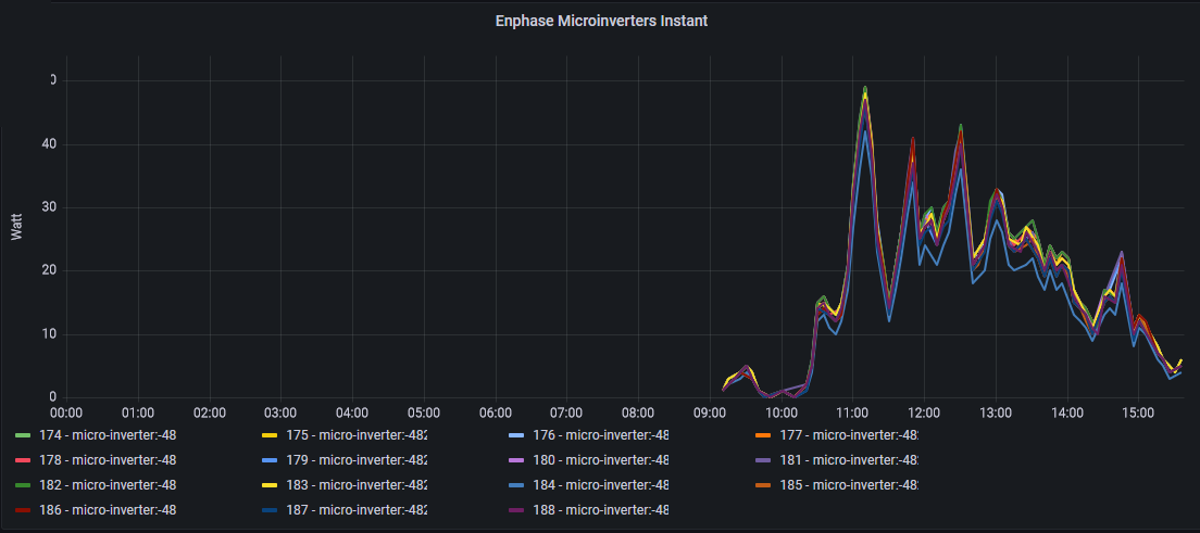

Working now! Is there any way to get a single graph with all the lines from all micro inverters in it?
SanderRoelofs wrote: Tuesday 19 July 2022 14:57 Only create a dummy hardware device not sensors.
local Enphase = {
ip = 'ip_address',
SanderRoelofs
Posts: 17
Yes and no.
I'm using Influx with Grafana for viewing graphs

I want to monitor my Enphase meter
I put the script available on the 1st page (thanks to the author!!) in the events
I created a Dummy and the idx 16 was assigned by Dz.
in the settings, there is the authorization to create new sensors.
