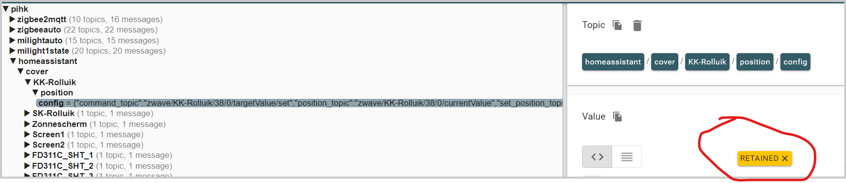

All CONFIG messages are send from your hardware gateway (ZIGBEE2MQTT/ZWAVEJS2MQTT...etc) to Mosquitto, the MQTT message daemon, and they are likely send with RETAINED=true. This means after they are send to the MQTT daemon, they will always be there and containing the latest information.
So in this case you have send the CONFIG messages to the wrong MQTT TOPIC previously, but they will be there until you manually remove them.
Just use the MQTT Explorer in windows to have a look at all message in the HOMEASSISTANT topic and delete all that aren't CONFIG messages:
This shows a correct message, where the last name in the TOPIC is CONFIG. Any other message should be deleted by clicking the BIN icon right-top or just hit the delete key when the topic is selected:

Ok thanks, I will try this and let you know. Thanks for your help.
