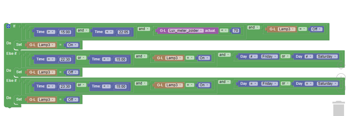

I have this blockly script which has to do the following:
- After 15:00 and lux lower than 70 then switch on the light (that step works fine)
- Than switch the lamp of during weekdays at 22:31 (that works fine too)
- Or switch off the lamp during the weekend at 23:31 (this does not work, the lamp will be switched off at 22:30 )
What is wrong here?
I tried all kind of settings but it
still does not work.
Thanks in advance.
Rick8245

Your Second condition is true in every weekday.
Change "Not friday or Not saturday" to "not friday and Not saturday".

Hi BennY,
It works GREAT !!!!
Thank you very much
