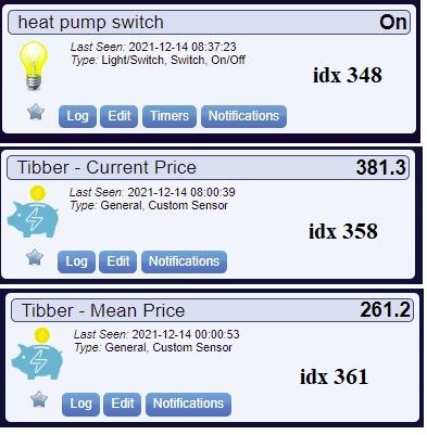

Heya. During the day sometimes we get some insane spikes in the energy price. I wan't to lower the heat pump setpoint during those spikes.
I wan't to activate a switch (which lowers the set point on the heat pump) when the current price is above average for that day +10. So if the average for the day is 100, then I wan't to activate the switch if the current price is above 110.
The heat pump switch has idx 348.
The current price has idx 358.
The mean price has idx 361.
heatpump switch.JPG (65.35 KiB) Viewed 431 times
Apreciate any help, thanks.

nvm :) I think I got it working with this script.
return
    on =
        devices =
            'Tibber - Current Price',
    logging =
        level = domoticz.LOG_DEBUG,
        marker = 'heatpump control',
    execute = function(dz, domoticz, variables)
        local heatpump = dz.devices('heat pump switch')
        local meanprice = dz.devices('Tibber - Mean Price')
        local currentprice = dz.devices('Tibber - Current Price')
        if (currentprice.sensorValue > meanprice.sensorValue + 10) then
            heatpump.switchOn().checkFirst()
        elseif (currentprice.sensorValue < meanprice.sensorValue + 10) then
            heatpump.switchOff().checkFirst()
